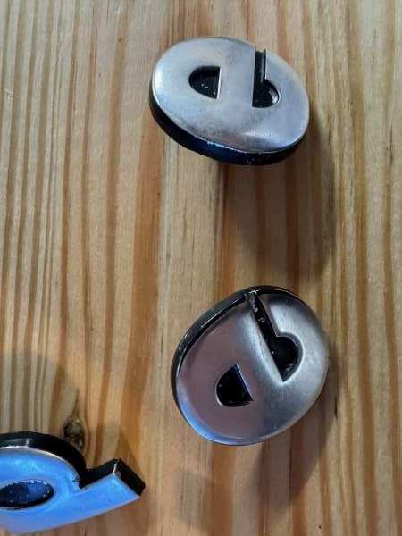

fiatslug87 Posted November 26, 2025 Share Posted November 26, 2025 Polish them: 220 grit mechanical sander to remove blemishes, sequential 1000, 1500, 3000 grit wet sanding then polishing with a DA polisher and Meguiar’s 105 followed by 205 compounds. Hard to get a good picture of the final result but you get the idea. Link to comment Share on other sites More sharing options...

JimiGibbs Posted November 26, 2025 Author Share Posted November 26, 2025 14 hours ago, fiatslug87 said: Polish them: 220 grit mechanical sander to remove blemishes, sequential 1000, 1500, 3000 grit wet sanding then polishing with a DA polisher and Meguiar’s 105 followed by 205 compounds. Hard to get a good picture of the final result but you get the idea. Those are beautiful..... Thanks for the information!!!! Link to comment Share on other sites More sharing options...
