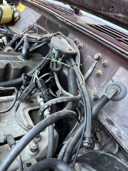

hgeranium Posted 16 hours ago Share Posted 16 hours ago Just now, TheNerfsmith said: I still have the CAD that I’m looking to delete. As for the line I’m not exactly sure which one it is but it’s in this photo. What’s that on the back of the valve cover? That’s supposed to be a PCV grommet and line that goes to the intake manifold. It almost looks like the CCV hose that’s on the front of the VC. I can’t really make anything out. There is a line going from the map sensor to the throttlebody, right? I can’t even see that in the picture but you would definitely know if you didn’t have it lol. Do you have any audible vacuum leaks? Or are you just trying to clean it up Link to comment Share on other sites More sharing options...
TheNerfsmith Posted 16 hours ago Author Share Posted 16 hours ago 4 minutes ago, hgeranium said: What’s that on the back of the valve cover? That’s supposed to be a PCV grommet and line that goes to the intake manifold. It almost looks like the CCV hose that’s on the front of the VC. I can’t really make anything out. There is a line going from the map sensor to the throttlebody, right? I can’t even see that in the picture but you would definitely know if you didn’t have it lol. Do you have any audible vacuum leaks? Or are you just trying to clean it up I actually have no idea why that line on the back of the VC is like that. One of the 3 previous owners put on a cold air intake so maybe that why it’s like that but I have no clue since the MJ runs fine. Albeit with a drop in RPM when the brake is pressed, but I documented why that could be in my build thread. Link to comment Share on other sites More sharing options...
hgeranium Posted 16 hours ago Share Posted 16 hours ago Just now, TheNerfsmith said: I actually have no idea why that line on the back of the VC is like that. One of the 3 previous owners put on a cold air intake so maybe that why it’s like that but I have no clue since the MJ runs fine. Albeit with a drop in RPM when the brake is pressed, but I documented why that could be in my build thread. Do you have a picture of the entire engine bay? Link to comment Share on other sites More sharing options...
hgeranium Posted 16 hours ago Share Posted 16 hours ago Just now, TheNerfsmith said: One of the 3 previous owners put on a cold air intake so maybe that why it’s like that but I have no clue since the MJ runs fine. Where does that hose go to? I would imagine that a CAI would not change the routing of your PCV because it’s going into the intake manifold itself. The grommet and hose are very cheap, like $14 if you end up wanting to go back to stock. Link to comment Share on other sites More sharing options...

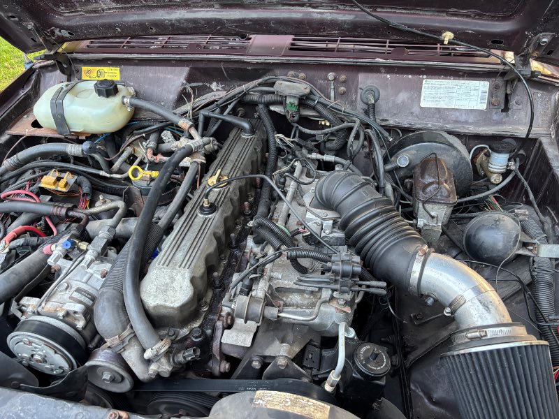

TheNerfsmith Posted 16 hours ago Author Share Posted 16 hours ago Just now, hgeranium said: Do you have a picture of the entire engine bay? Hopefully this helps. I probably can get a better one if need be. Link to comment Share on other sites More sharing options...
hgeranium Posted 15 hours ago Share Posted 15 hours ago Just now, TheNerfsmith said: Hopefully this helps. I probably can get a better one if need be. Woah what the heck. One of your PO switched the PCV and the CCV locations on the VC. I guess if it works. And since you have a CAI I’d be willing to bet you can get rid of that unsightly vacuum tree with a bit of rerouting or modification. I’m assuming your CCV hose just gets routed directly to the ground? Or into a catch can? That’s how I have mine since it kept putting oil in the air filter Link to comment Share on other sites More sharing options...
hgeranium Posted 15 hours ago Share Posted 15 hours ago 4 minutes ago, TheNerfsmith said: Hopefully this helps. I probably can get a better one if need be. I also see your vacuum ball is on the intake side of the motor. Is it hooked up to the HVAC at all? It’s on the other side of the engine Link to comment Share on other sites More sharing options...
TheNerfsmith Posted 15 hours ago Author Share Posted 15 hours ago 10 minutes ago, hgeranium said: I also see your vacuum ball is on the intake side of the motor. Is it hooked up to the HVAC at all? It’s on the other side of the engine What I do know is that my A/C still works and blows cold so I assume it is connected? Maybe not?, I have no clue. Link to comment Share on other sites More sharing options...
hgeranium Posted 15 hours ago Share Posted 15 hours ago Just now, TheNerfsmith said: What I do know is that my A/C still works and blows cold so I assume it is connected? Maybe not?, I have no clue. Look to the right and down from the coolant bottle. There should be a black rubber oblong piece with 2 vertically aligned vac lines. One line goes to the vacuum canister ball and the other goes to the heater control valve. A bad vacuum line will make the air always come out at defrost. The vac leak at my heater control valve made my air blow hotter and not nearly as hard as it does now, so it’s worth a look just in case. Link to comment Share on other sites More sharing options...
