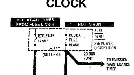

87MJTIM Posted August 8 Share Posted August 8 The clock fuse is only hot in run. The fuse that is hot at all times for the clock is the ETR. I would suggest you check the grounds for the radio. Cruiser was always harping on grounds. My experience was with the clock. It would sometimes display or display very dimly. I did Cruiser's instrument panel ground upgrade and the clock displays bright now. To quote the Beach Boys: "Ground, ground, get a ground, i need a ground." (or something like that.) Link to comment Share on other sites More sharing options...

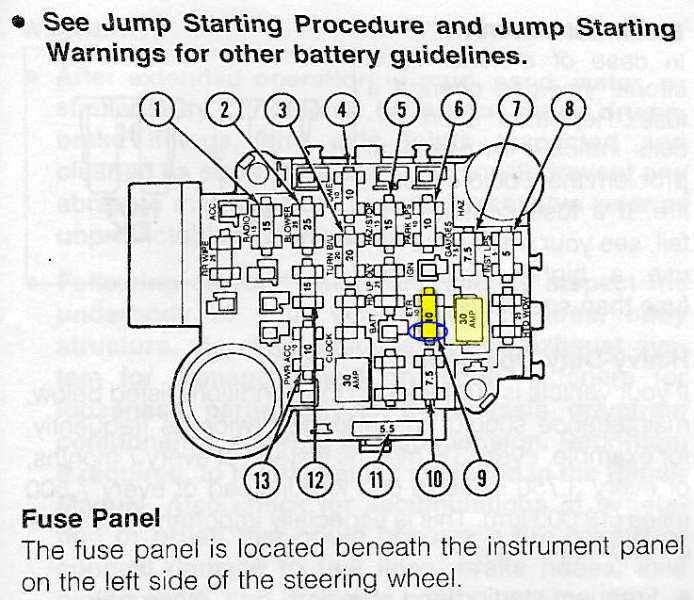

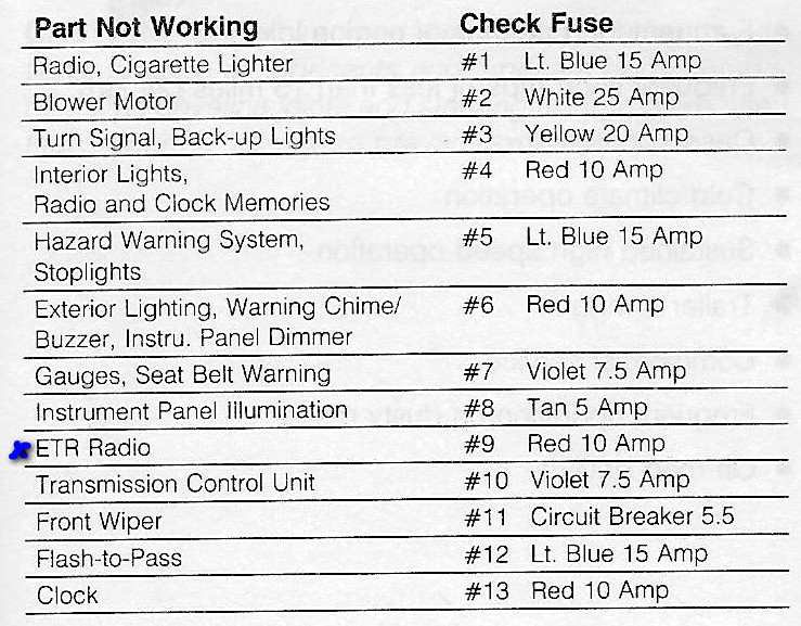

AnotherOldJeepGuy Posted August 8 Author Share Posted August 8 Hmm, I don't have an ETR Fuse! There are no contacts for it at the bottom end (circled) and there is no "ETR" printed on the assembly as other labels are. I also don't have the 30A that is shown next to it in this scan from my owner's manual, not that that's related to this problem, just noting it doesn't exist either. Since the radios I have installed over the years, including the current one have all worked since 1990 until yesterday, and I don't see 2 fuses laying on the floor, it's pretty reasonable to assume these have never been there on my particular vehicle. So whatever my issue is, it doesn't appear to be a blown ETR fuse in my case. Perhaps this, and the 30A, exist for some other MJ variant? Link to comment Share on other sites More sharing options...
