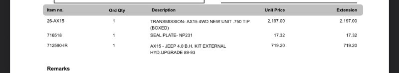

InTacosWeTrust Posted August 5 Author Share Posted August 5 1 hour ago, 89 MJ said: Shouldn't need a transfer case. You'll definitely need the bellhousing, clutch fork, throw out bearing, slave cylinder, master cylinder, and clutch line for sure. Probably more things that I'm not thinking of right now. I'd look into something like this: https://www.advanceadapters.com/4993?gad_source=1&gad_campaignid=19546564555&gbraid=0AAAAAD7cfhBqvj96u4j13cQJFlOR4rlF5&gclid=Cj0KCQjw18bEBhCBARIsAKuAFEZJHYG3uV8D148Y5nY8DA_pYdeT7CtFY5_uvGZCFq8TgbckdMdDX7kaAqMPEALw_wcB Would I need a new clutch or do you know if the one from AA or Novak comes with one already? I just put in a new master as well, would that not work with the slave from their kit? AA quoted me this and told me this is all I would need Link to comment Share on other sites More sharing options...

InTacosWeTrust Posted August 5 Author Share Posted August 5 44 minutes ago, 89 MJ said: I can't say for sure whether you'd need the clutch or not. I would doubt that the either one comes with a clutch though. I wish I could be more help, but I went from a Peugeot to an external slave AX-15 and replaced all of the hydraulics and clutch at the same time, so I can't say what exactly actually NEEDS changing for your swap. I'll tag @Htchevyii as he has been through this before. I'll also link the video they did on their channel. Thank you!, so I guess from this video I’m going to buy the Novak ax15 trans from them, buy the AA parts I got quoted, along with a new throw out bearing, flywheel, input shaft seal. If I’m leaving anything out let me know, i figure I would use the same clutch kit and master since I replaced it less than 100 miles ago and the clutch kit is a for a 1992 any recommendations on flywheels? Link to comment Share on other sites More sharing options...

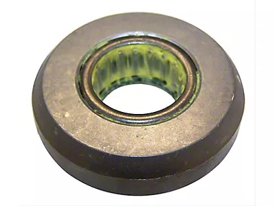

JZLAJeep Posted August 8 Share Posted August 8 32 minutes ago, InTacosWeTrust said: Where do you find that flywheel and updated pilot bearing? You can take your existing flywheel to a machine shop and ask them to resurface it for you. Cost us about $60 last time. You can buy the pilot bushing from a 70's CJ that will replace the pilot bearing. I found this old write up here Link to comment Share on other sites More sharing options...

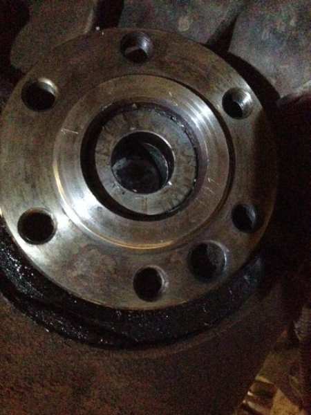

Htchevyii Posted August 8 Share Posted August 8 Yes, the crankshaft has a spot for a smaller pilot bearing in the inner smaller hole or the larger OD one that fits into the outer hole. You need the larger one. I think that I just used a 97 one. Some people have reported a 74 or so Jeep 304 bushing fits too, but I can not verify. If you buy a later model one, you need to get one with the spacer, (see pic). Link to comment Share on other sites More sharing options...
