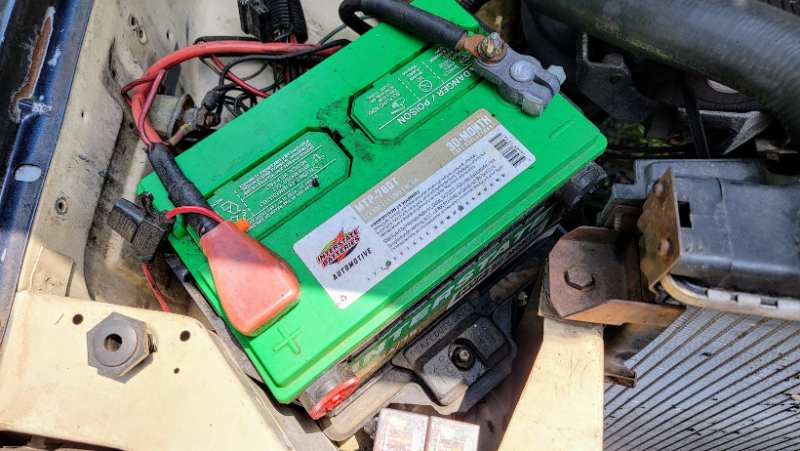

coheed Posted June 28 Share Posted June 28 5 minutes ago, eaglescout526 said: You got a group 34 in yours? I wasn’t able to get one in my 84XJ Technically a group 78, but same same. This is the interstate battery I have in there currently. This is the battery tray that was in the truck when I got it. I also have the tray out of my grandad's truck in the shed and it's the same style, even though this truck is a late 86 and my grandad's was an early production. Link to comment Share on other sites More sharing options...
coheed Posted June 28 Share Posted June 28 Actually, reading the specs I just realized it's a little wider and taller than the group 34s they offer, but an 1/8" shorter on the long side. Maybe that's why it fits and you couldn't get a group 34 in there? Link to comment Share on other sites More sharing options...
eaglescout526 Posted June 28 Share Posted June 28 1 hour ago, coheed said: Actually, reading the specs I just realized it's a little wider and taller than the group 34s they offer, but an 1/8" shorter on the long side. Maybe that's why it fits and you couldn't get a group 34 in there? That’s probably why. But group 78 is good to know. Link to comment Share on other sites More sharing options...

coheed Posted June 28 Share Posted June 28 3 hours ago, eaglescout526 said: That’s probably why. But group 78 is good to know. 1 hour ago, ratrapp said: thanks guys,i 'm going to make the 58 fit but if the poor 2.8 survives long enough to outlast this battery ill go with a 34 or 78. No problem. Also an fyi, the 78s are normally only side terminal batteries. The reason I got this one is it has both top and side terminals so it would be easier to connect a second battery or run power to my camper at some point. So, if you get a 78, make sure it works with whatever cable ends you have. Link to comment Share on other sites More sharing options...
ratrapp Posted June 28 Author Share Posted June 28 yeah you used a 78 dt which has both side and top terminals where a standard 78 has just side posts. Link to comment Share on other sites More sharing options...
