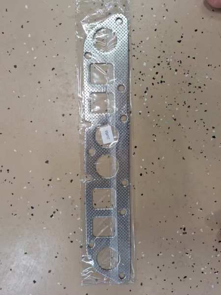

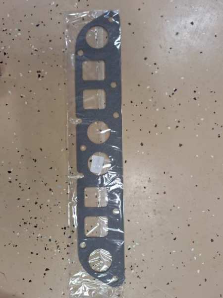

garyweb3 Posted June 21, 2025 Posted June 21, 2025 I planned on replacing my intake gasket on my 1987 Comanche w/2.5L engine. The first one I purchased has a foil surface on both sides. When I removed the manifolds I found a crack about 2/3's of the way around the exhaust manifold. I purchased a new replacement which came with a new combo manifold gasket. One side has the foil surface and the other side has a typical paper look. Which one is better if there is any difference and which surface goes toward the head?
eaglescout526 Posted June 21, 2025 Posted June 21, 2025 I’ve always had fitment and sealing issues with the full manifold gasket. Chrysler used the one piece for the intake manifold until 2001 when they stopped making the engine. I don’t recommend the full ones but, you already have them. Which ever one will fit best and work without any issue, run it. Neither surface makes a difference.
