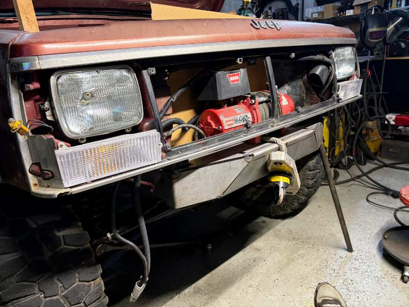

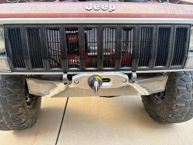

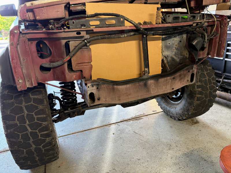

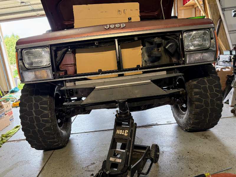

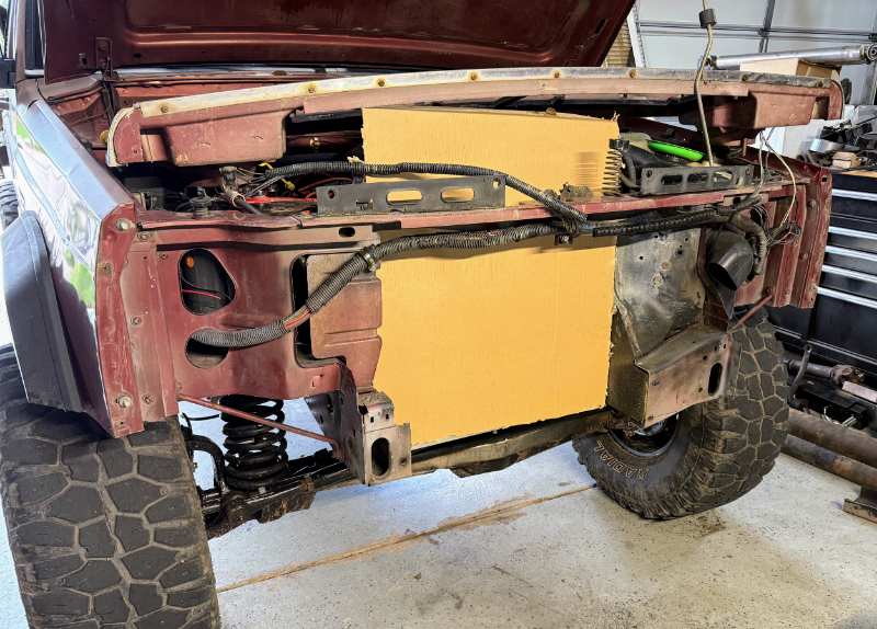

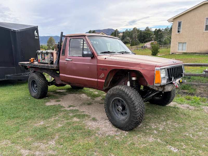

jeeper_chiefb Posted September 3, 2025 Author Posted September 3, 2025 The bumper is a stubby YJ/TJ bumper, which I used as a frame chop winch mount behind the grill on the MJ. I previously had a JCR Vanguard and didn't like how far it stuck out reducing approach angle. .new bumper concept Making space by relocating wires and cutting out sheet metal.

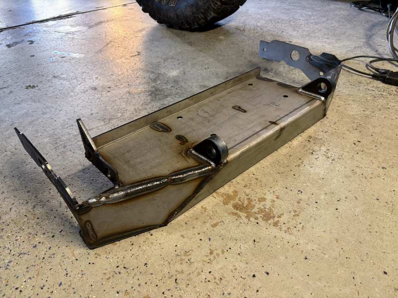

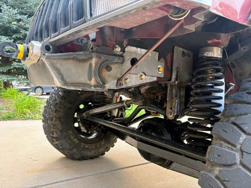

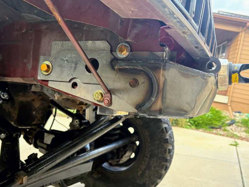

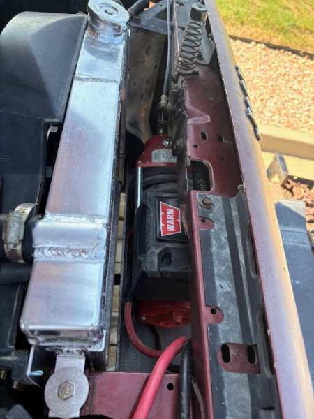

jeeper_chiefb Posted September 3, 2025 Author Posted September 3, 2025 The key to making this winch mount work behind the grill, while keeping the stock radiator mount, is this short drum Warn 9.0 winch. It's also possible because there is no A/C condenser. I chopped up the bumper to get it around MJ parts, but added gussets on the inside for support and XJ brackets to the outside for bolt on.
89 MJ Posted September 3, 2025 Posted September 3, 2025 Any plans to add something that would help protect the header panel?
jeeper_chiefb Posted September 4, 2025 Author Posted September 4, 2025 I trying hard to minimize weight but the corners of the lights are definitely exposed. I'll probably add a flat plate under the turn signals for protection.

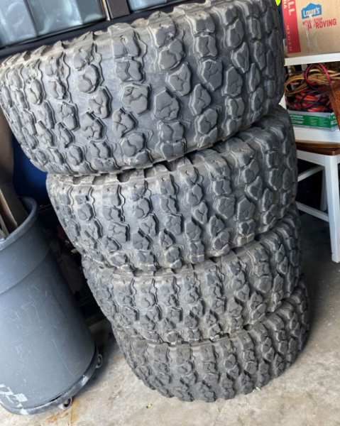

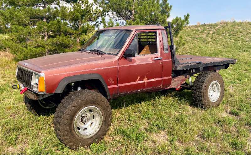

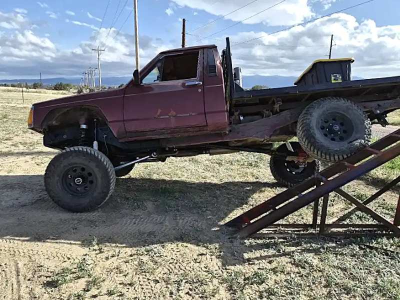

jeeper_chiefb Posted September 10, 2025 Author Posted September 10, 2025 I had a flat tire one morning about a week ago and found the 33s had a dry rot and cracking leading to leaks. I have some leftover 5 lug beadlocks from my YJ project after going to 8 lug, so I searched for 17" tires for the MJ. I found these 35x12.50r17 Yokohama Geolander X-MTs on marketplace and the seller really wanted garage space so I got them for 400. After a night of mounting in the garage I put them on the MJ and found the 35s need more lift and fender clearance.

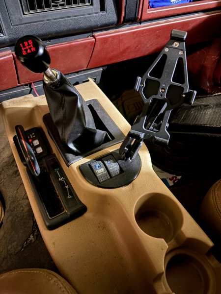

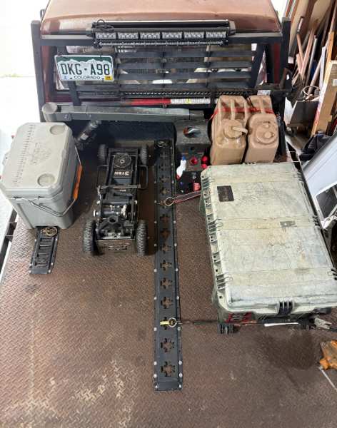

jeeper_chiefb Posted September 22, 2025 Author Posted September 22, 2025 I got the ARB compressor mounted under hood and added switches in place of the ashtray with a printed piece. I've also been adding to the flatbed with accessories and whatnot. So far I've added a fuel and water jug, a Pelican 1630 for tools and recovery gear, fluid storage for 2 gallon jugs and 4 quart containers, a 3 ton offroad jack and cooler. All of it is temporary as I want to maintain the ability to haul dirt bikes or an ATV on the flatbed.

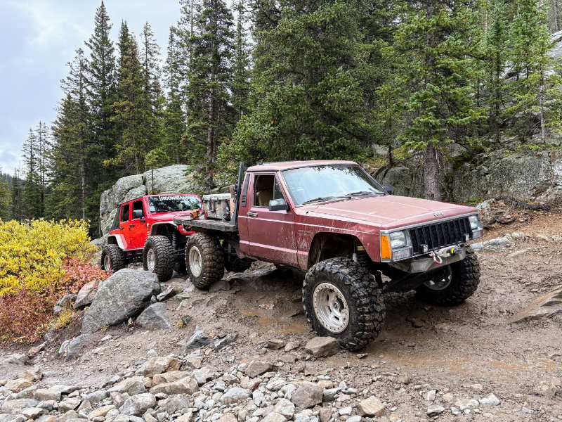

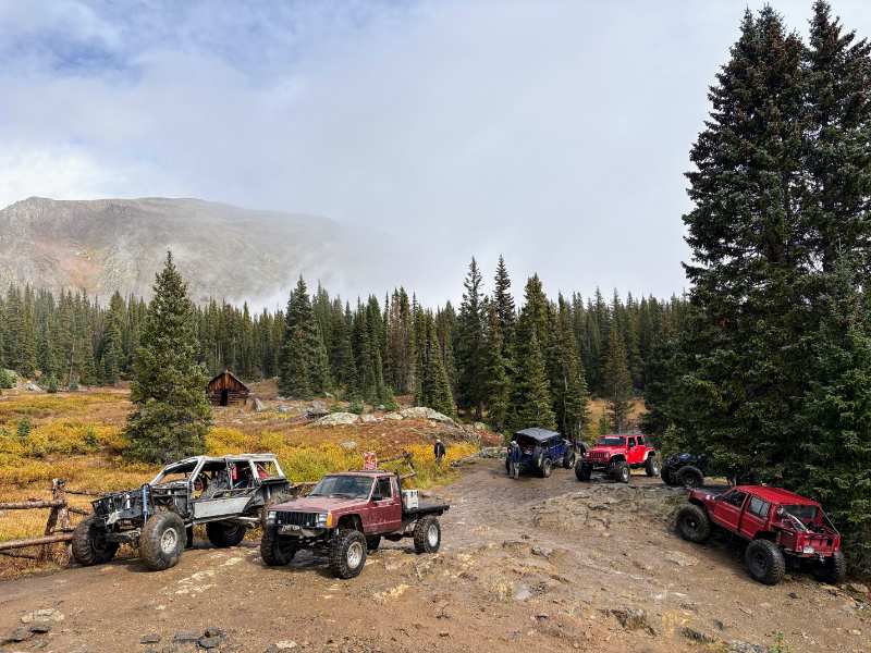

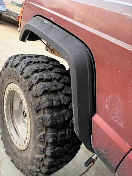

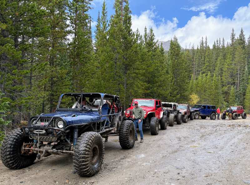

jeeper_chiefb Posted September 22, 2025 Author Posted September 22, 2025 Still working on tire clearance in the front. I trimmed the inner fender and flare at the rear but the 35s continued to grabbed the plastic when compressed. So I traced the flare with my plasma and removed the entire inner fender. No more plastic but now some clean up to do, so I ordered some Notch Customs flares for the front. The fender trimming was Friday and I made the trip to Holy Cross trail Saturday. Outgunned in my group of buggies and Jeeps on 40s but I was there and made it to the top. Rained all day so a couple winch pulls were required and happily my custom winch mount didn't pull apart.
jeeper_chiefb Posted October 2, 2025 Author Posted October 2, 2025 Before I packed it away for my 9 month trip to Iraq I experimented with some street tires/wheels. I tried to find the lightest aluminum wheels possible, as well as light duty all terrains. 32x9.50 Maxxis Liberty tires and 15x7 American Racing wheels

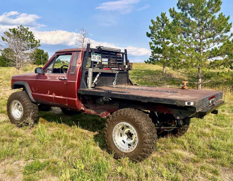

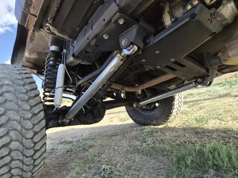

jeeper_chiefb Posted September 29 Author Posted September 29 I did some more work on the MJ. I finally got around to welding together and installing the Barnes4WD crossmember with t-case skid plate. Also plated the frame with Barnes plates and installed 2" 7075 aluminum lower links with 1.25" joints.

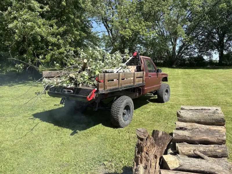

jeeper_chiefb Posted September 29 Author Posted September 29 I then towed it from CO to MI and used it as a lumber truck on my mom's property. It will stay there while I am stationed in Korea. My nephew has been driving it and installed a new clutch to keep it going.
ThatJeepGuy Posted September 30 Posted September 30 On 9/29/2026 at 12:06 AM, jeeper_chiefb said: I then towed it from CO to MI and used it as a lumber truck on my mom's property. It will stay there while I am stationed in Korea. My nephew has been driving it and installed a new clutch to keep it going. Where abouts in MI? Nice updates to the truck BTW!
