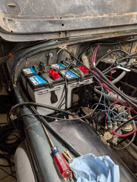

derf Posted November 3, 2025 Author Share Posted November 3, 2025 Making more progress on wiring and so forth. Got the battery tray in and the two batteries in place. I'm going to build my own isolator switch system. That's up next. Link to comment Share on other sites More sharing options...

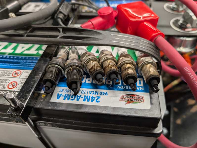

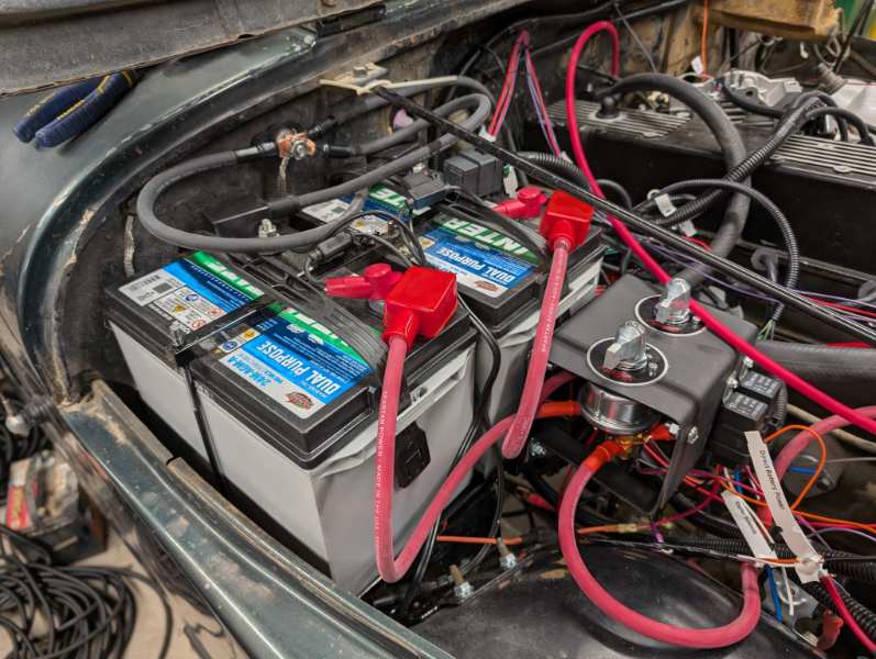

derf Posted November 9, 2025 Author Share Posted November 9, 2025 Got the manually controlled dual battery setup in. One switch for each battery to connect/disconnect it. I can run either battery or both if I want. Still have a bunch of wiring to finish. Also did the spark plugs. It may have been running a tad rich... Link to comment Share on other sites More sharing options...

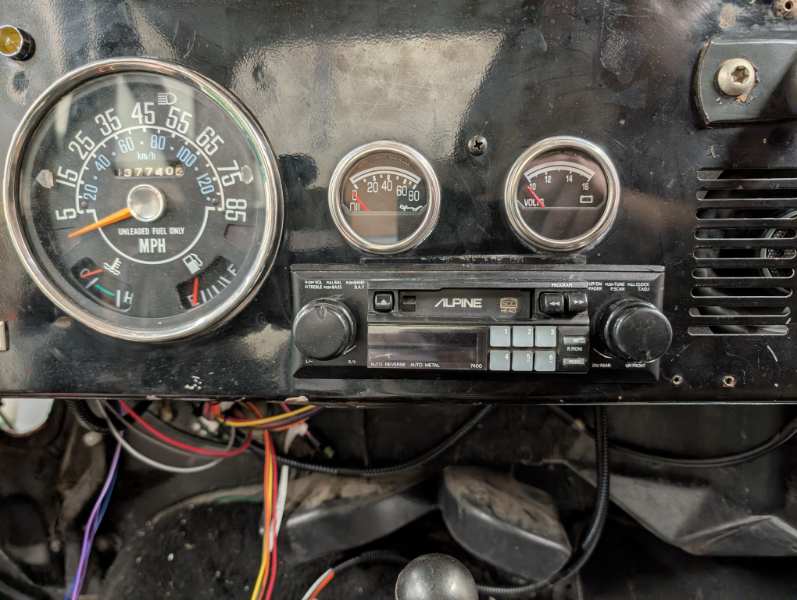

derf Posted December 6, 2025 Author Share Posted December 6, 2025 Slow progress, but I mostly got the dash buttoned up. Splurged a little on ebay... Link to comment Share on other sites More sharing options...

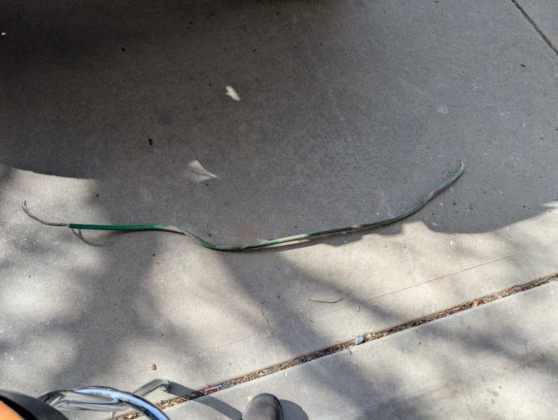

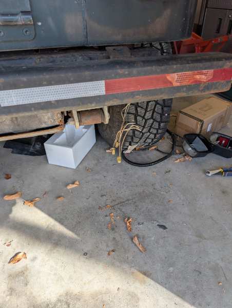

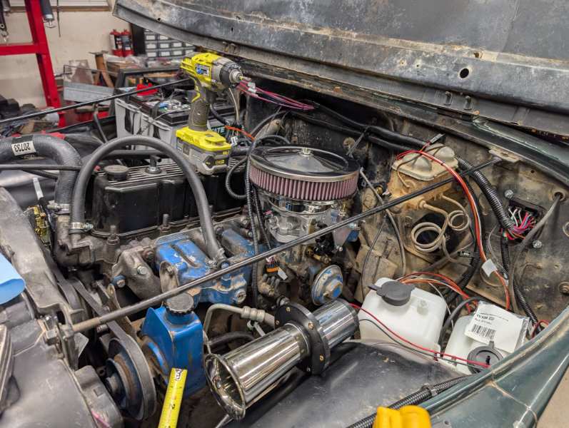

derf Posted February 1 Author Share Posted February 1 It's warm in the garage this weekend so I have been making progress. Still fixing the DSPO (Dip "Stick" Previous Owner) problems. They apparently rewired the tail at some point. They ran wires in a stretch of garden hose to push them through from one side to the other. Then they attached them with wire nuts. I'm running the Painless kit that is a direct bolt in for a CJ. So I am gutting everything and running new replacement wiring. So it will be nice again and run properly. To that end, I need to drop the gas tank to run the wires properly. I'm going to go ahead and replace the skid plate with aftermarket. May as well while it's out. The tank hangs low so more protection is never a bad thing. Also, I mostly finished setting up the engine wiring. The CJ harness is pretty universal on that end from Painless. So I had to integrate the Duraspark ignition and tie it in with the Howell TBI kit. And I went ahead and did the heavy power cable for all the aux wiring I'm doing. All tied in to the dual battery switches. Oh, and I needed two relays. One for the TBI and one for the manifold heater circuit (needed for emissions in Denver). It's a little over engineered but it's better than random butt splices all over. And the plugs let me service it in the future. The oil pressure sending unit is sitting there waiting for me to crawl under and put it in. I need to finish wiring up the radios (CB and GMRS) and a few other things. Should be ready for spring. Link to comment Share on other sites More sharing options...

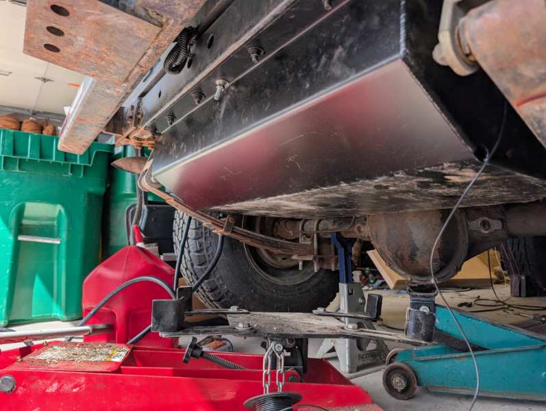

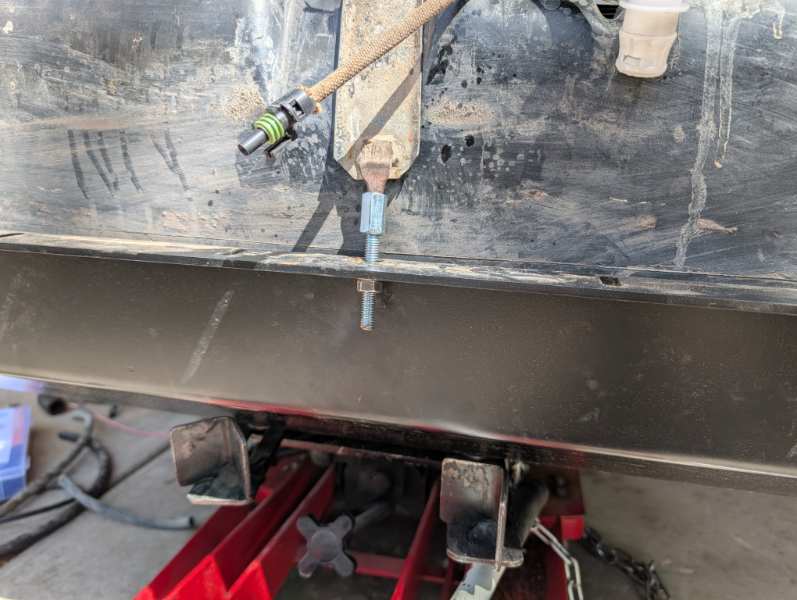

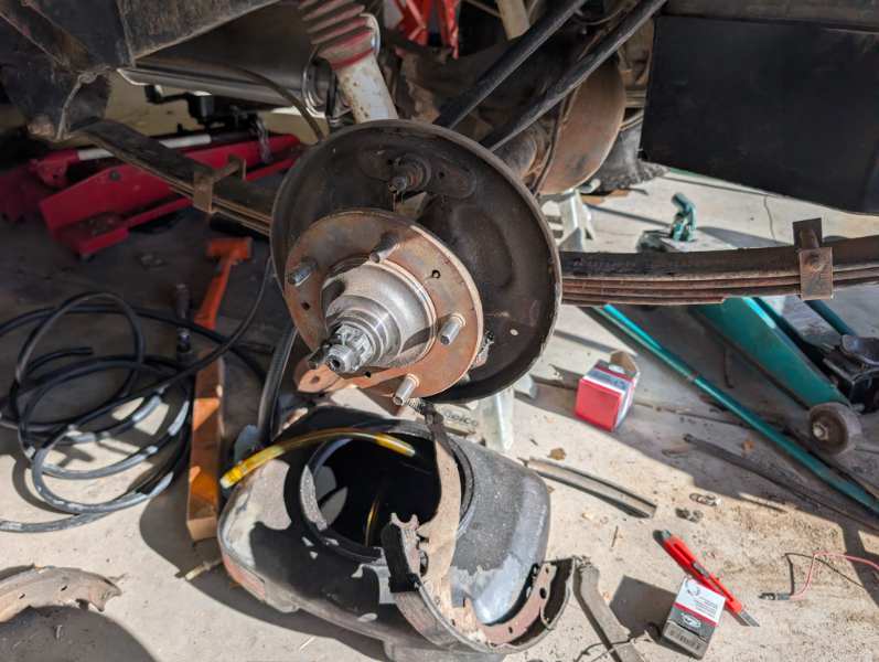

derf Posted March 13 Author Share Posted March 13 I've been having fun with the old broken gas tank strap. But the rear wiring has been done for a bit. I'm running new hoses (vent, supply, and return) as long as it's all apart. The Genright tank skid os quite a bit beefier than the stock. So I feel good about installing it. I've mostly been poking at a few odds and ends. Got the front bumper and fog lights installed so it looks more like a CJ now. Link to comment Share on other sites More sharing options...
