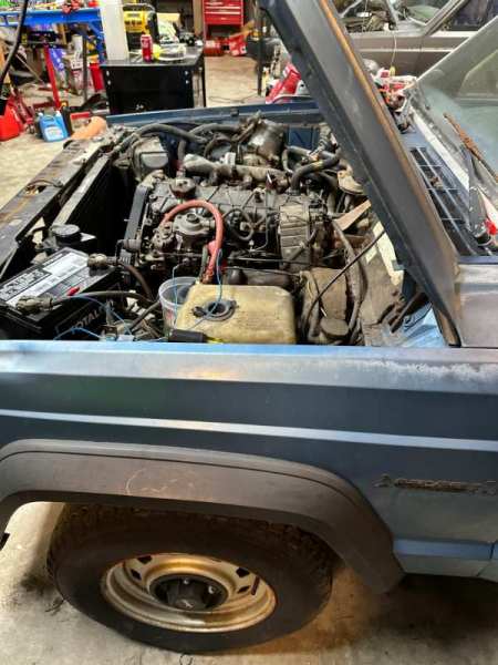

ThreeComanches Posted November 10, 2024 Author Share Posted November 10, 2024 First order of business was to remove the old trashed 2.1 engine. With it being opened and exposed to the elements, it was seized up. Only hard part was getting the engine out with the aftermarket air shocks making the front of the truck raise up real high. I ended up pulling the header panel off so the oil pan wouldn't damage it. The engine i plan to put back in will be a 2.1. I have one out of a Cherokee TD but I'm unsure of the condition. Link to comment Share on other sites More sharing options...

ThreeComanches Posted June 6, 2025 Author Share Posted June 6, 2025 Hey everybody! About time for an update isn't it? So a good bit has went on with this ole truck since the last update. First of all, the engine I ended up choosing for this truck in November was a factory 2.1 out of an '86 Cherokee Diesel with 99k miles. Initially, I wasn't sure of the condition as it had been sitting since 2006. Everything looked to be in good condition and it wasn't locked up so I went ahead and installed it. I tried to spin it over and see if it would fire but had no luck. I ended up putting it aside as I had other matters on my plate at that time. In January, I finally got back on to diagnosing it and decided to swap the injection pump. Upon doing that, the engine finally came to life. It was cold so it had a hard time starting. It also ran rough and wouldn't respond to the throttle. I also flushed out the fuel tank since the fuel in it had been there since 1995. So what's left? I need to install the transmission, have the injection pump rebuilt, redo the cooling system, and potentially fix the AC. Link to comment Share on other sites More sharing options...

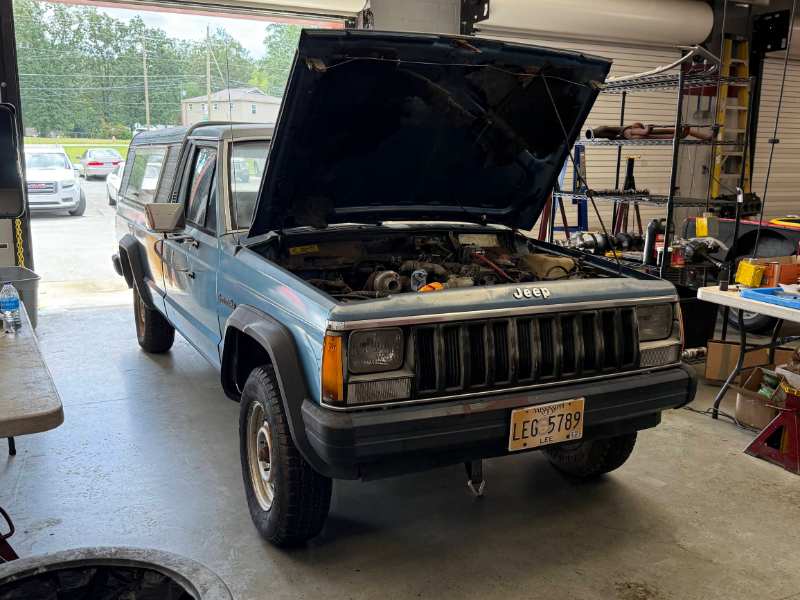

ThreeComanches Posted September 19, 2025 Author Share Posted September 19, 2025 So a lot of progress has been made... I finally installed the transmission, got the brakes working with a new master cylinder, installed new clutch master and slave cylinders, and bled the cooling system. However, the water pump had a huge leak so that needed attention asap. I was lucky enough to get the last one available off of rock auto. Once I got it in and installed it, the leak finally went away. Link to comment Share on other sites More sharing options...

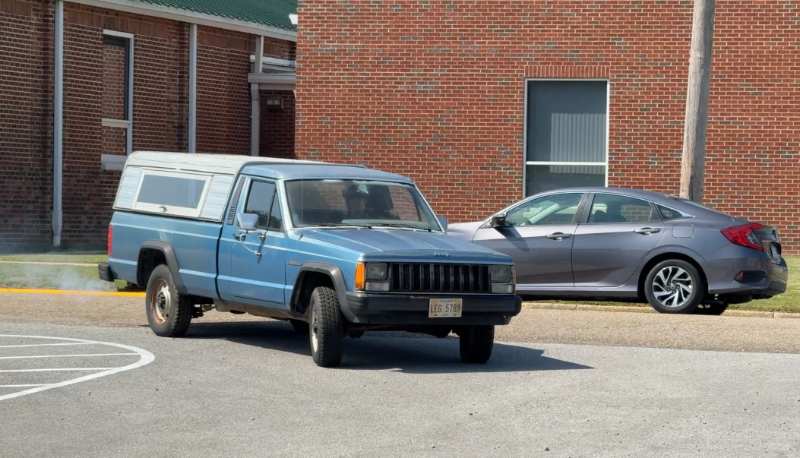

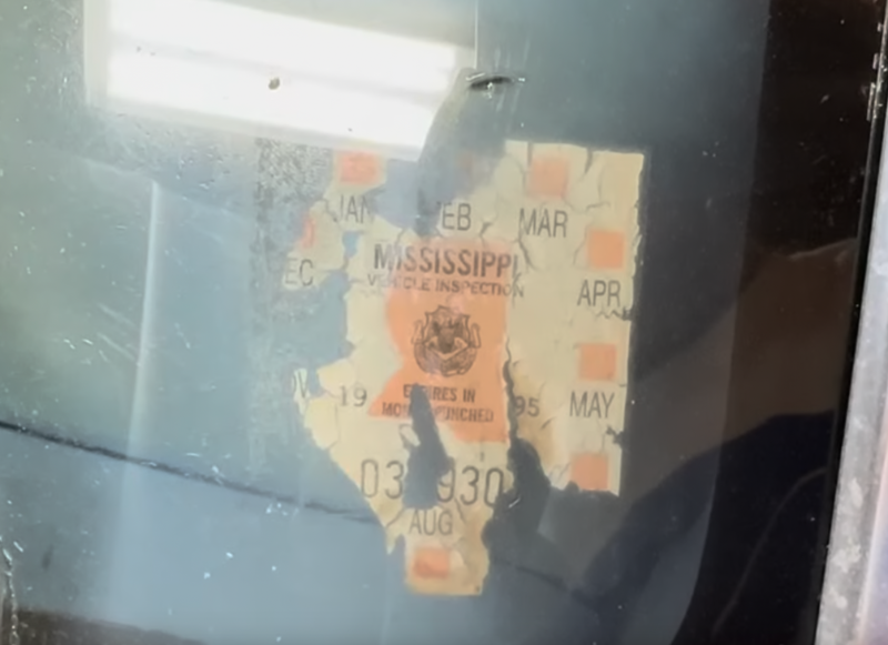

ThreeComanches Posted September 19, 2025 Author Share Posted September 19, 2025 Ladies and gentlemen, for the first time since September of 1995... the Mississippi Turbo Diesel rides again! After looking in the registry, I also found out this is the latest built factory diesel Comanche. It might even potentially be the last one. This one took about a year and a half to get back on the road and I still got plenty more to do to it cosmetically. Even then. it's a thrill to have another one of these rarities back on the road. I also included a picture of the last inspection sticker. Funny enough, Mississippi doesn't have vehicle inspections anymore! Haha Link to comment Share on other sites More sharing options...
