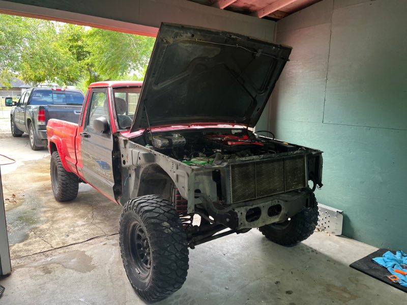

Flexj Posted April 19 Author Share Posted April 19 This was like December of 22โ I want to sayโฆ with the Comanche sitting and me doing ok for myself I decided to start finishing the 97 swap (doors and fenders) which kinda escalated to an LS swapโฆ. ๐คฃ Link to comment Share on other sites More sharing options...
Flexj Posted April 19 Author Share Posted April 19 Made sure to get all the seals and consumables replaced while the engine was outโฆ. Figuring out what clutch and flywheel to use for this setup was like pulling teeth! The nv3500 5 speed is out of a 95 k1500 and the engine is from a 03 express vanโฆ I used a clutch and flywheel from a 2003 Chevy Silverado 2wd. Iโll need to find the part number for the throw out bearing as that was the most difficult part to find. Also pulled a few broken header boltsโฆ dunno why Chevy always gotta be breaking the header bolts.ย Link to comment Share on other sites More sharing options...

Flexj Posted April 19 Author Share Posted April 19 Got that stinky old 4.0 and ax15 the @#$% out of there. ๐คฃ everything is bigger in Texas, including me, and not in the way I would have chose if I had the option. ๐คฃ๐คฃ there is like, literally nothing to do here in Brownsville except eat and drinkโฆ luckily Iโve lost most of that weight now hahahaaย Link to comment Share on other sites More sharing options...
Flexj Posted April 19 Author Share Posted April 19 Started getting the LS fitted in there. The overkill by design mounts are 10/10โฆ I love being able to source motor mounts at any parts store, they are well built and I couldnโt be happier with how it placed the motor. Honestly itโs more comfortable working on this v8 in this engine bay then the 4.0 was. ย I ended up taking a break after being โattackedโ by this huge man eating spiderโฆ dang Texas with its snakes and spiders, I miss the bears and cougars of Oregon. ๐คฃ truthfully I love Texas but I wish I was in northern Texas.ย Link to comment Share on other sites More sharing options...

Flexj Posted April 19 Author Share Posted April 19 Alright so the LS is running from these pictures forward. I tried to upload the startup video buts it too large. Iโll try to edit it down and get it in here. Long story short I ended up finished painting the cabโฆ between the quality of the work he did do, and the reputation from his son taking customer rigs out when they have cool motors in them I decided it was in my best interest to finish it myselfโฆ so out a little on that part but not much. Kinda wish I just did it all myself with how easy it isโฆ I had a feeling, I do rc car bodywork for a hobby and just had a feeling I shoulda done it myself. I was also a little disappointed in how much hardener he used.. he said he wanted to make the paint tough for a jeep, but what I learned is it just cracks.. if you lean on it, try to cut it, anything it cracks.. so whatever you do the more flexable The paint the better when it comes to jeeps imo. Also you can see what the factory color was with the bed removed. Thats what I was trying to match.ย Link to comment Share on other sites More sharing options...
