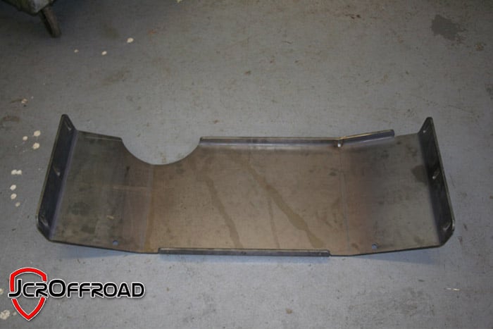

yellaheep Posted July 13, 2015 Posted July 13, 2015 JCR's website says this is their XJ skid with no mention of it fitting an MJ, nor do they offer one for an MJ. Any reason this won't work on an MJ? Anyone got this one on their rig? Thanks!
Incommando Posted July 13, 2015 Posted July 13, 2015 The MJ has twice as many mounting bolts on the crossmember and that might be one reason? Or maybe they just never mocked it up to an MJ
FrankTheDog Posted July 15, 2015 Posted July 15, 2015 That skidplate doesn't use the factory mounting holes.
Strokermjcomanche Posted July 15, 2015 Posted July 15, 2015 This Full Traction Skid plate / crossmember #720646 fits both the mj / xj both auto and manual , the ba10 needs an adapter . Just an option if the JCR doesn't fit .
