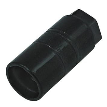

HOrnbrod Posted May 1, 2015 Share Posted May 1, 2015 Use an oil pressure switch socket like the Lisle 13250 or a deep 1-1/16" socket. . If you don't have one, channel locks work too. :thumbsup: Link to comment Share on other sites More sharing options...
Scalped Posted May 1, 2015 Author Share Posted May 1, 2015 I have the one that works a guage it's made differant bottom is much smaller than the top. And it's behind ac Link to comment Share on other sites More sharing options...
HOrnbrod Posted May 1, 2015 Share Posted May 1, 2015 Then it's a sensor or sender, not a switch. Look like this? or this? Link to comment Share on other sites More sharing options...
