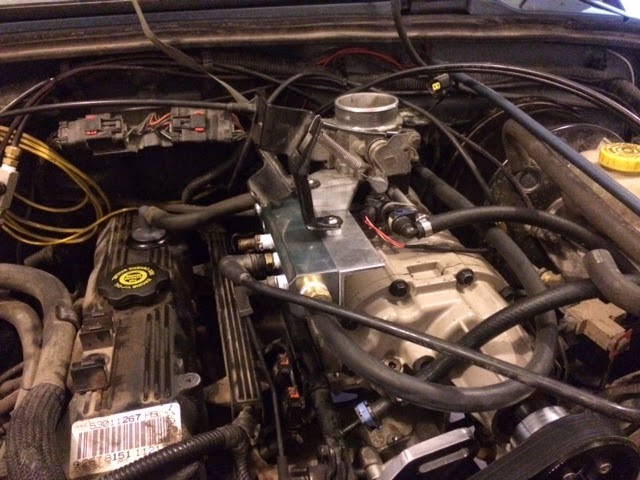

Jeep Driver Posted August 2, 2014 Author Posted August 2, 2014 Image Not Found Image Not Found Image Not Found Image Not Found Image Not Found Image Not Found No change in rough idle.
Jeep Driver Posted August 2, 2014 Author Posted August 2, 2014 Image Not Found I don't know if you can see much in this pic but the injector seems louder than usual and it soaks the throttle plate at low idle.....seem to be around 300-400rpm What are the chances of the injector going out?
cruiser54 Posted August 2, 2014 Posted August 2, 2014 Image Not Found I don't know if you can see much in this pic but the injector seems louder than usual and it soaks the throttle plate at low idle.....seem to be around 300-400rpm What are the chances of the injector going out? It could be dirty. Search BG 44K on Google.

Jeep Driver Posted August 5, 2014 Author Posted August 5, 2014 There was a seller on Ebay selling a complete throttle body for $250, NOS They are no longer available complete because they sold all the injectors out of them. I was able to find them on the net and I contacted them today. I will need to find a used injector to send to them to be rebuilt and installed in a new TB. They will ship for $200. I used some Rislone injector cleaner and ran about 5 gallons of gas through it today, idle really smoothed out but sill low. I'm pretty certain my problem is with the injector, but If I'm gonna spend the money I'll just replace the whole thing while it's still available.
