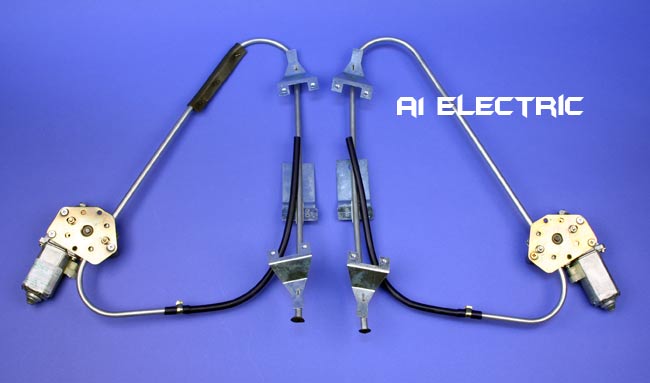

Because of the high failure rate of the crappy factory regulators I got new regulators from the link below. These are quality regulators made in Italy, and about twice as fast as the factory ones.  I've had them in for about four years now. I sold my old manual regulators on Ebay and got almost all my $$ back that I paid for the new power regulators. I'm cheap that way.  :yes:
http://www.a1electric.com/Merchant2/merchant.mvc?Screen=PROD&Store_Code=AEOS&Product_Code=JE01-K
