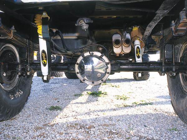

feerocknok Posted February 27, 2007 Share Posted February 27, 2007 hey guys i thought i had found a passenger drop 44 but when i went back to the junkyard it turned out to be something else ill try to get a pic of it but can anyone show me pics of a cj d30, chevy 10bolt, and a few others? so i can compare..thanks I'm assuming it's that SAS Blazer? All 30s look the same. 10 bolt (used in fronts and rears) 44 And a gasket diagram: Link to comment Share on other sites More sharing options...

feerocknok Posted February 27, 2007 Share Posted February 27, 2007 the more i look at chevy axles the more it looks like the chevy 7.5 or w/e.. with 10 bolts on the cover.. which is what this axle has... can i get 5.13s with these? are they strong? Here's the 7.5" Randy's Ring & Pinion says it was used only in the rear of Blazers, Camaros, vans and some other stuff. Assuming it's a 10 bolt front, they aren't real strong, but a lightweight rig should do okay. Fullsize guys aren't hot for em with 5000+ lb trucks on 35"+ tires. And another Randy's quote says, "Spline Count: 1.625 / 30" And gearing of: 2.56 3.08 3.23 3.42 3.73 4.11 4.56 4.88 5.13 5.38 5.57 A 44 would be a better option if you could find one. Link to comment Share on other sites More sharing options...
