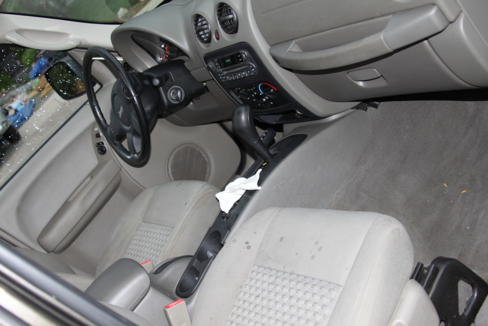

Sir Sam Posted September 1, 2011 Author Posted September 1, 2011 Spent today cleaning it inside and out, looking pretty sharp now:
