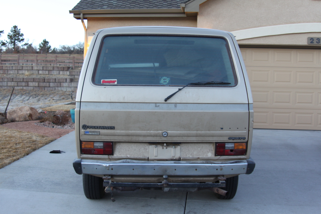

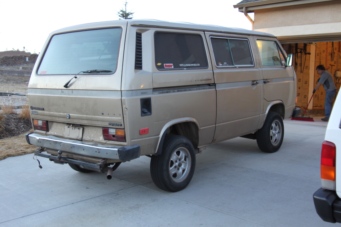

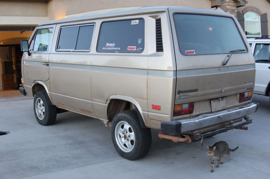

Well the time has come for me to start a build thread. I've had this syncro since november of 09, and the project has just been on hold since then. Basically I picked up in town, drove it home and then around the neighborhood a couple of times, and then parked it.

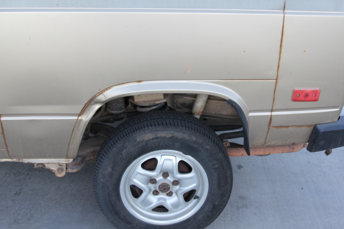

So, this is what I am starting with, '87 7 pass syncro with ~225k, a broken odometer(perhaps the next thing on the list), single rear locker, plenty of minor body damage around(the kind that takes many hours for such a small thing), rust free body, minus the usual seams.

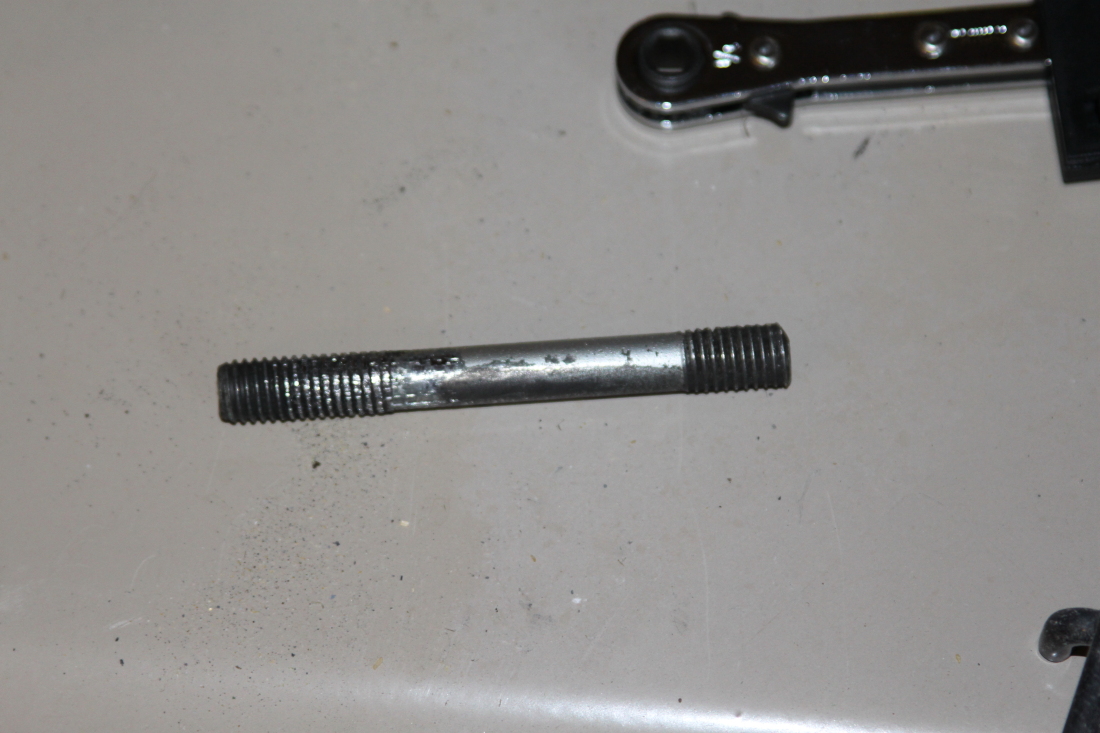

It had a "clutch problem" when I bought it that turned out to be broken rear lower bellhousing studs. In this video you can see that the greasy gap changing size is the transmission and the engine mating surface, they should be completely together, but with only the upper bolts in place the action of pushing the clutch in and out causes the whole shebang to articulate there, made the clutch engage super close to the floor and almost un-drivable, lots of throttle and slipping was required to get it started in gear.
This is the broken stud I was able to remove:
I wasn't able to find an allen head bolt that was long enough to replace the stud(the longest I could find was m10x1.5x70mm, and a 80mm is needed.
Because of the clearance a regular 80mm hex head bolt won't clear either.
Ended up using a 80mm threaded rod on the passenger side. The drivers side was tighter and I couldn't even get the old stud out, ended up threading the stud back in and leaving enough to get a new nut on the old broken part, so theres a little less thread engagement there, and theres now a threaded rod on the passenger side, but it sure beats a transmission pull, its much better than it was, and the van is actually somewhat drivable now.
The clutch still feels "soft" compared to the brand new one in my 91, and it feels like it "chatters" when engaging it, so I'm sure a new clutch would be good, but for now the van is drivable, which is the important part. Plus I don't really want to goto the PITA to drop the trans and throw on a new clutch when I want to convert to another engine anyway.

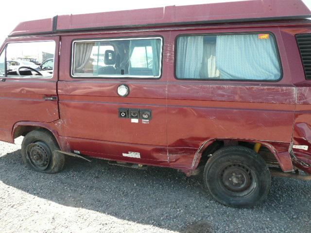

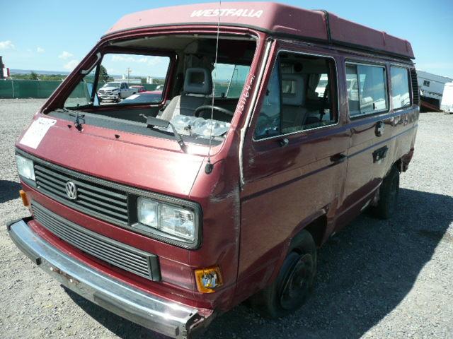

So when I converted my 91 to a westy I just kinda lucked out and found a good fiberglass top on CL(from a guy who told me about the samba) at the same time that I bought the van. I figured I would make the top work while engineering my own hole opening and bunk rails. After getting that top and seeing how most people did conversions by drilling the spot welds I decided that would work better. I found a van at a junkyard, got all the westy interior out of it, then went back and cut off the roof. That worked nicely, and it looked stock. But that method is super labor intensive, I cut a corner by leaving the roof section over the driver intact, and making a seam/splice just above the B pillar.
Even so as anyone who has done a conversion knows, thats super labor intensive. The other option at the time was to take the roof skin to just outside the aluminum rail that holds the canvas top down, I think this is the method I am going to use on the syncro because:
A) it saves time, and labor, lots of it
B) the outer parts of my donor westy roof are mangled up in a few places
C) its just as strong and water tight if you weld the sheet metal fully around.

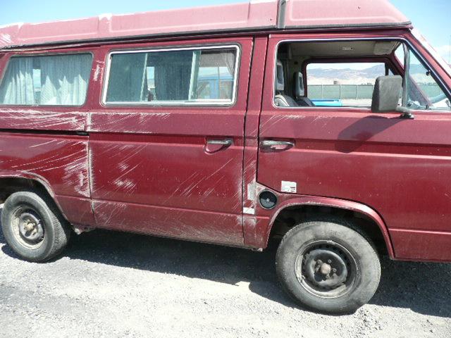

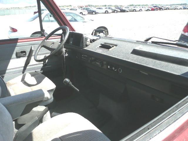

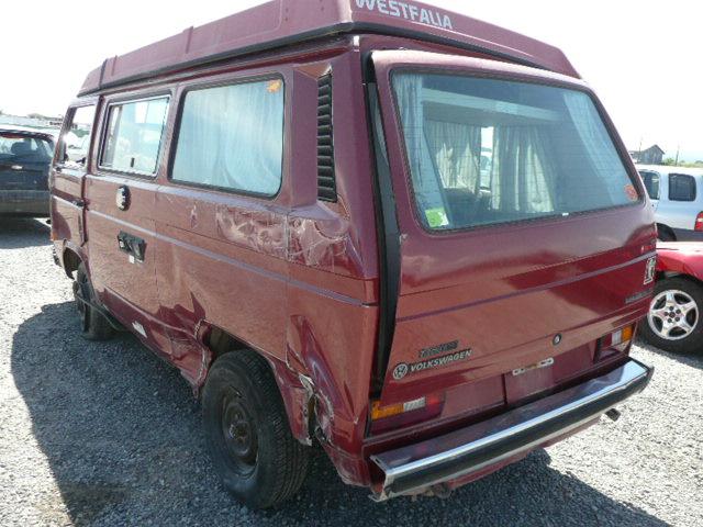

So this is the donor van, an 87 full westy that was rolled. It's still a nice driving van, none of the suspension was damaged, the engine still runs fine, has a rebuilt trans, was a super super clean westy, but the whole upper body is tweaked to the left, so it really is beyond repairable. Really though, I just want it for the pop top conversion and the newer grey interior(no offense to the guys with the exterior brown vans and brown interior vans, but yuck, the grey interiors feel clean and modern to me, despite being almost 25 years old)

With that bellhousing shifting back and forth you have guaranteed pilot bearing issues, and probably a cracked clutch disk hub. I'd definitely pull it before it explodes, or your input shaft bearing grenades.
