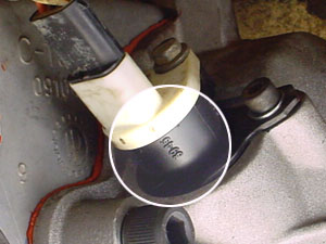

Geonovast Posted October 22, 2009 Share Posted October 22, 2009 maybe your cable is getting loose so maybe time for a new one. I think he's referring to his 91. It could be a dying sender, or a frayed wire losing power on its way to the speedo. Link to comment Share on other sites More sharing options...
veritas4156 Posted October 22, 2009 Author Share Posted October 22, 2009 I think he's referring to his 91. It could be a dying sender, or a frayed wire losing power on its way to the speedo. Yep, the 91 has this problem. The 86 has bigger stuff to fix. I'll grab another sender from the JY and trace the wire and see what happens. Thanks Link to comment Share on other sites More sharing options...
LEAD_NOT_FOLLOW Posted October 23, 2009 Share Posted October 23, 2009 First thing I'd do is make sure your speedo gear on your TC is set correctly. There are different settings on it based on how many teeth your speedo gear has. You can "index" it by turning it to the correct location based on the teeth you have. Their are numbers on the side of it. Link to comment Share on other sites More sharing options...
