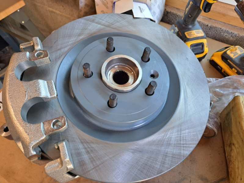

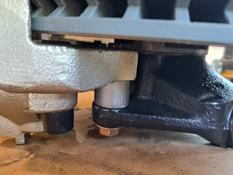

JeffK Posted April 23, 2025 Author Share Posted April 23, 2025 Started mocking up the front brakes today, the write ups I've read they've had to remove 1/16 to 1/8 of material off either the hub or the rotor center. I literally sanded of the coating on the rotor center and they slid on. Drilled out the mounting ears and chased the ball joint sleeve threads, which went surprisingly well. I started assembly of the knuckles and realized the caliper bolts I have are too short. The bolts needed are M14 - 1.5 x 70mm, I ordered them online because I couldn't find any flange hex bolts that size locally. Link to comment Share on other sites More sharing options...
JeffK Posted April 29, 2025 Author Share Posted April 29, 2025 Spacers and bolts came in, mocked up and ready to install. Link to comment Share on other sites More sharing options...
