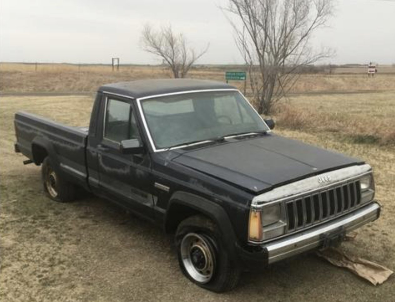

  5. tonight I’m making the decision to end the 86 project this truck is to far gone so I will be parting it out, I’m gonna make a trailer out of it but that means everything else is forsale if any of you need parts before they go to scrap or trash
  6. Nope no fuses just a random green wire laying in the engine bay
  7. Update the engine now turns over I found this random green wire spliced in and when touched to hot side engine spins over now I just need some spark
  8. Ok so today I checked fuses all were ok but still same story at the key no power to anything so I tried to jump the starter and that no longer spins it just melted the tip off my screw driver, even with the starter not work I should still have lights or something
  9. I even had the battery on the charger I still think I would have lights or a little sign of life but she’s just dead still i suppose tomorrow I’ll check fuses and install my new starter I had on hand
  10. Today I cleaned all my grounds there all nice shiny and clean even replaced the battery cables I hooked everything up and turned the key and nothing once again the key does nothing no lights no anything

  12. The starter just spins it doesn’t kick the bendix out and I’ve gotten many old trucks running and driving like my 1940 gmc truck but that engine was also run with about 4 wires, this 86 is the newest thing I’ve tried to bring back and is more complicated then what I’m use to

  15. I have a 1986 Jeep Comanche 2.5l 5spd it was last tagged in 2000 so 22 years parked untouched, I’ve finally got around to messing with it, I put a good battery in it and hit the key and nothing happened at all no lights or anything nothing worked so I jumped the starter and it turns but doesn’t engage and honestly I'm a novice at electrical and don’t know where to start.
