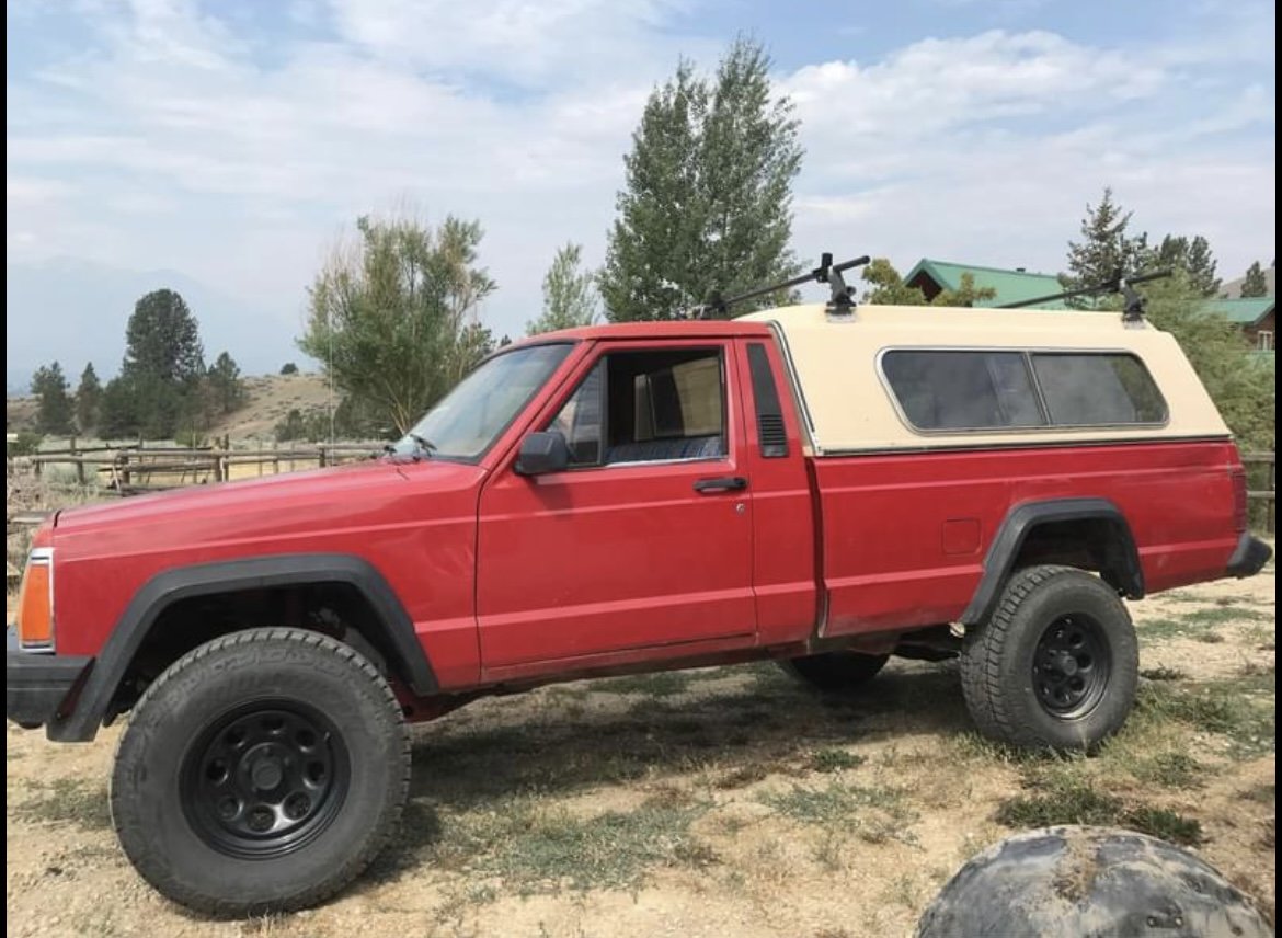

  9. Meant to add my truck to the registry long ago! 2.5, 5speed, sitting on dana 30/35. Bought last September here in Montana; currently residing in Missoula. Garaged atm until I get around to bringing engine back to life.
