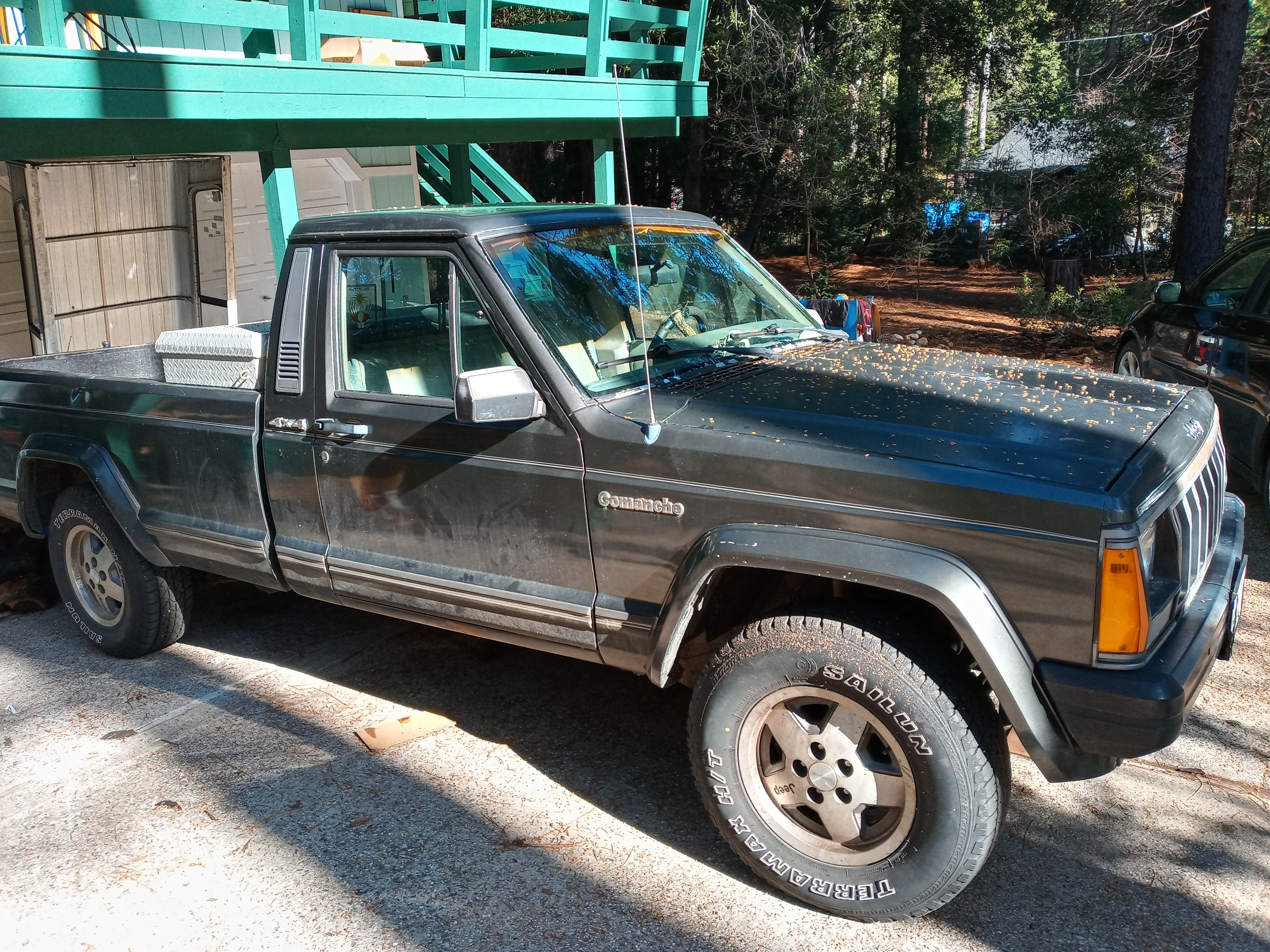

  8. hey, all I'm sayin' is, I'm super glad I only paid $4k and hope some day I can do it again.

  12. Every time another pops up for $10k+ in CA I feel better and better about the $4k I paid. https://sfbay.craigslist.org/pen/cto/d/pacifica-jeep-comanche-i6-manual-4x4/7294828604.html
