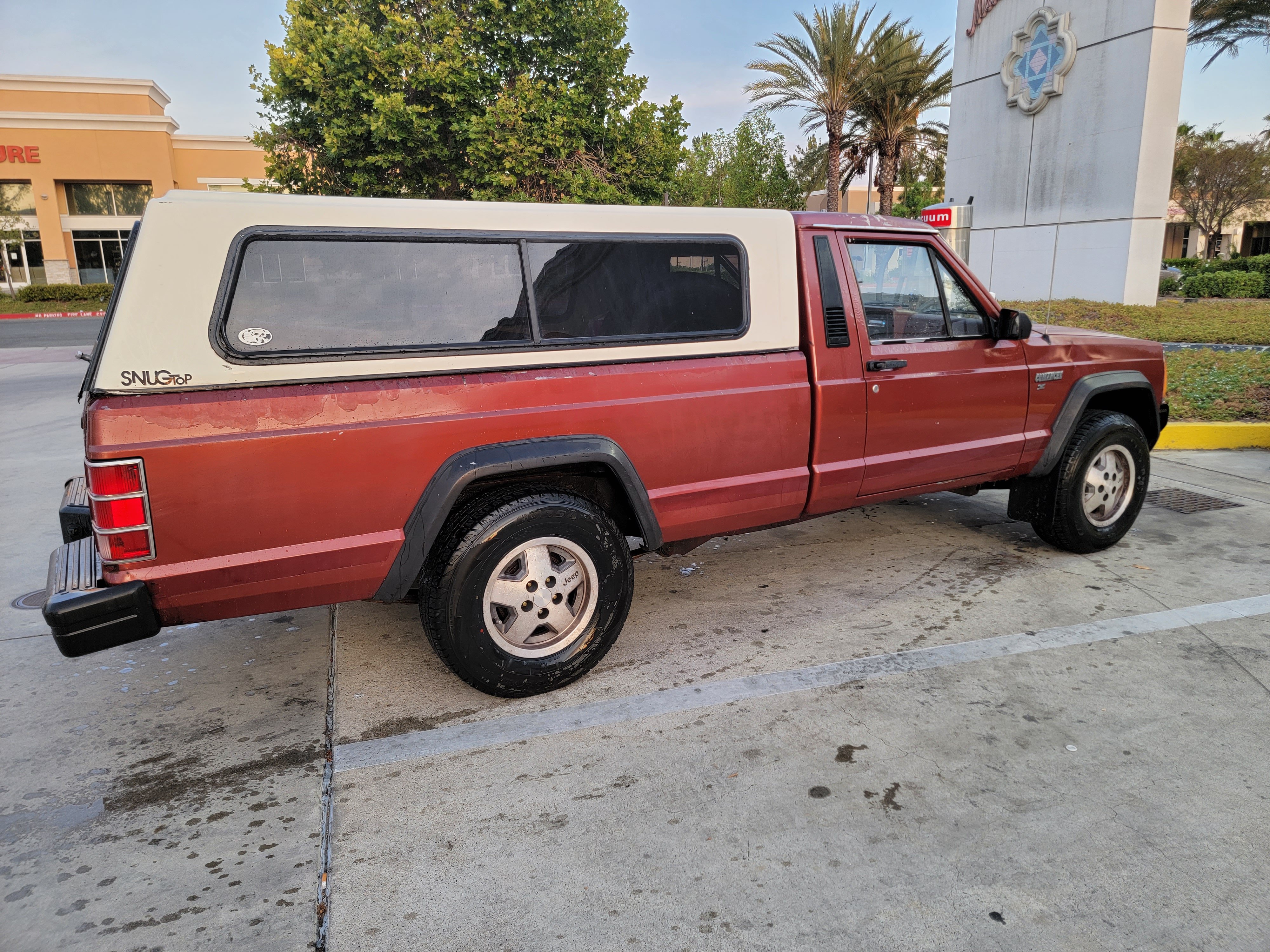

1986 Jeep Comanche Long bed. Originally Equipped with a 2.1TD Renault mated to an AX5 transmission as a 2wd truck. Unsure of the rear axle. The truck is now equipped with a 1.9 liter Volkswagen Diesel engine out of a 97 VW Jetta or Passat mated to a AX15 transmission, still as a two wheel drive truck. The factory door has been replaced and the build sticker is ineligible. I am the current owner of this MJ located in the sunny Murrieta, CA. The truck is currently going through its 2nd make over (that i know of, grandpa {johnj92131 was my grandpa and owner before i} funded the TDI swap for his own project and had his own desires with the truck). Currently it is getting the head rebuilt, head studs to handle MORE boost, and getting the engine bay re done to be more cosmetically pleasing. Getting rid of the clutter and making it look like a shaved engine bay with minimal wiring exposed, the fuel and oil lines are now going to be AN lines so they can be clutter free. Otherwise, the truck is still road worthy and currently registered in Ca as a clean truck that is legal. The Idea for the truck is to get a small lift, to get the weight of the truck up a little and make a wider stance. id like to use the diesel to flat tow my XJ out on long trips. At some point the truck will be fully restored, and painted. I will be experimenting with Megasquirt and a Racepack to see if i can get the TDI to communicate on a full stand alone ECU, if successful it will bring the truck into 2021 technology. Another mod that will hopefully come in the future would be converting from AX15 to a NSG370 for the 6 speed aspect and better gearing for a diesel
