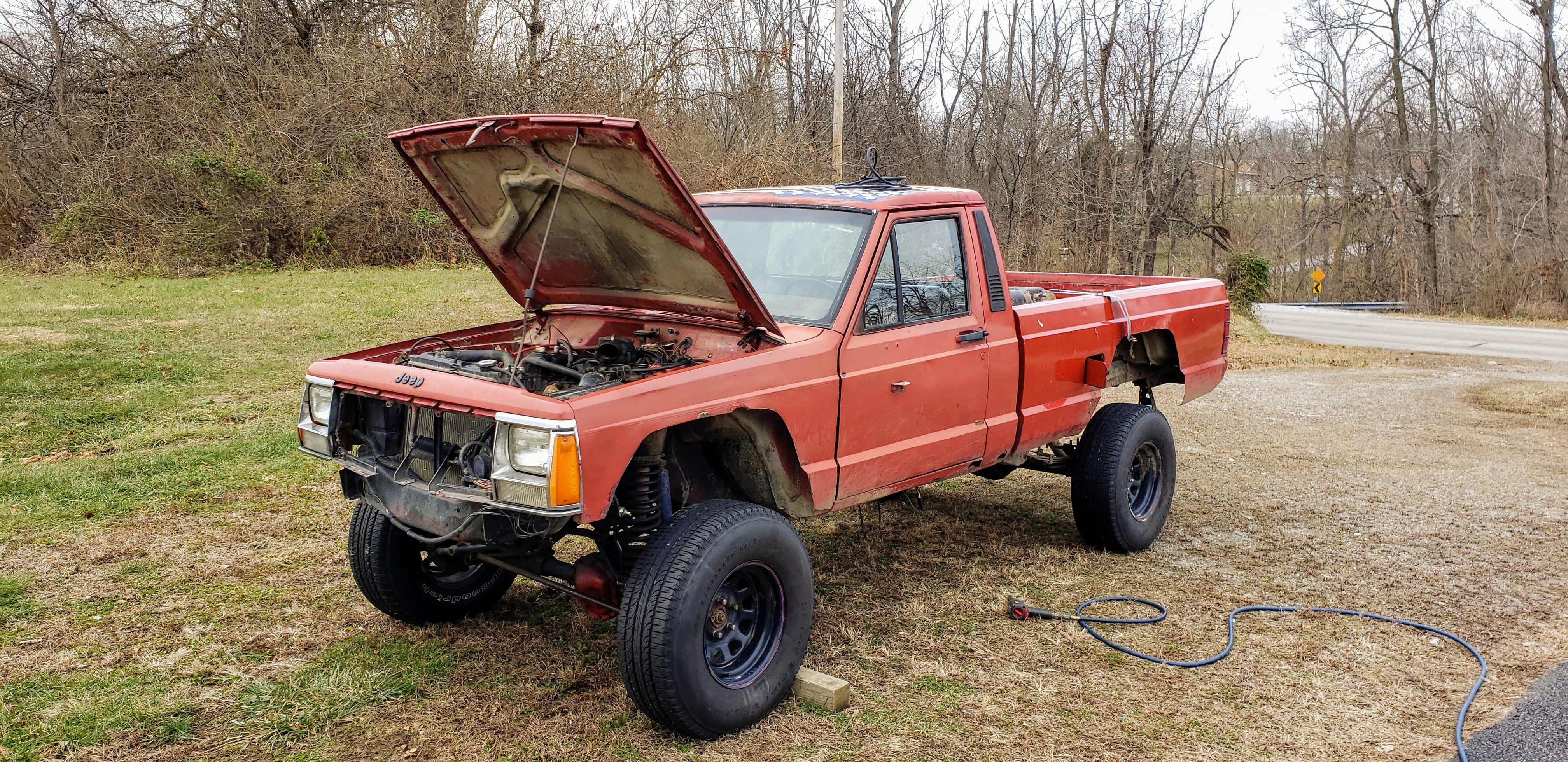

  1. That's what I'm working on now grounds and suspension are my main focus at the moment. The PO was trying to make it into a rock crawler, and I'm trying to undo all that.
  2. Thanks I'm just getting started getting this thing back to a dependable daily driver, I've just about got the suspension ironed out and a new tank/pump/sending unit in place and working like it should. Just getting started on all the electrical gremlins that seem to have been made worse by the previous owners.
