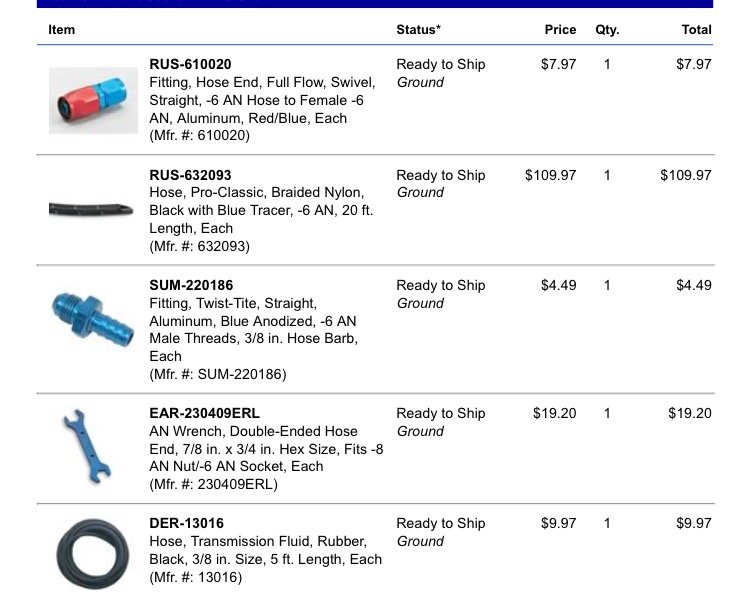

No prob. I was shocked I ordered everything all together lol
