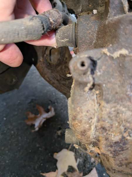

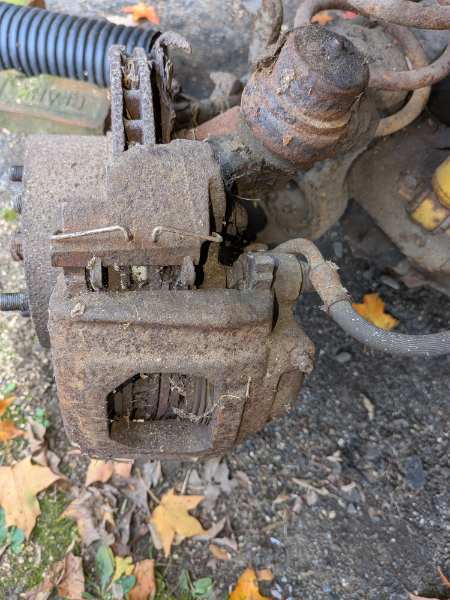

thejum57 Posted 3 hours ago Posted 3 hours ago It's been over 10 years since I've done a brake job. Are these the bolts to remove the front brake caliper? Where my finger is pointing & by the brake hose? Do those rubbber boot things come off, or does a socket fit inside? It's been sitting 5+ years and the front brakes are frozen up tight. It's time to go back on the road again! Thanks!
jdog Posted 2 hours ago Posted 2 hours ago Yes, those are the bolts. they should be an Allen head bolt if I remember correctly, which fits inside the boot
AnotherOldJeepGuy Posted 2 hours ago Posted 2 hours ago 2nd the allen head inside. I had my calipers off not too long ago and I don't believe the boot came off with the bolt.
