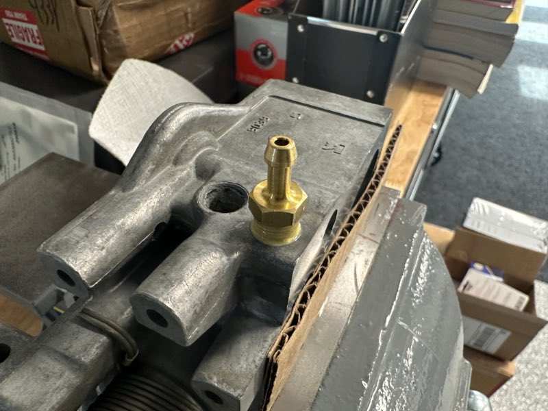

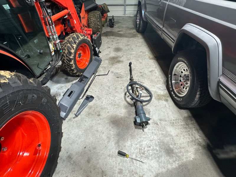

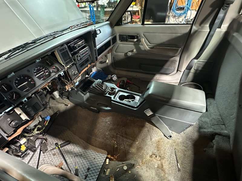

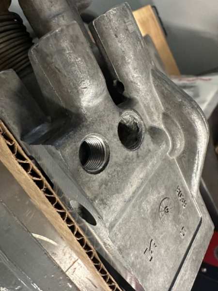

Started on the interior renovation. Rebuilt steering column is on the way as mine was pretty jacked up. Seats are at an upholstery shop getting the same fabric that was on it. Shop had a roll of it from way back when! I will remove seat belts and send them off since they do not retract well and are very grimy. I have new carpet to put in. Also waiting on some dash bits so I can close that up. While that's going on, I am working on the engine with all vac hoses being replaced. Tapped and threaded throttle body for permanent vacuum to map sensor fix. I can only work for short moments as my shop building is hotter than an oven.
