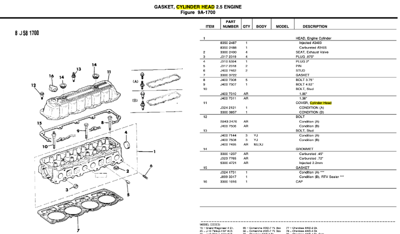

NickyV Posted June 9 Posted June 9 I'm looking at doing my head gasket. Trying to figure out which bolts I need. It's a 1987 2.5L. I'm not seeing any kits online specifically for the 2.5L, and based on the 1987 parts manual, it's not entirely clear to me how many I need with studs vs without studs. It just says "AR" or "use as required." But I'd like to replace them all. Pretty sure I need 10 total, but can anyone tell me with certainty how many I will need of #10, #9 and #8 to replace all of them?

NickyV Posted June 9 Author Posted June 9 Lol. I definitely didn't read the parts manual closely enough. It literally says I need five of the 3.75", one of the 4.52" and the rest are "as required," which would be four. And that is exactly what it looks like under my hood too.
