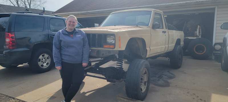

Hello and welcome to the MJ build for my wife.
Together since 2007 and she has dealt with my Jeep hobby since before then!

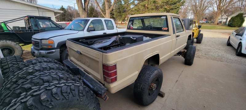

I aquired this one after initially hunting down a project for someone else and after said person bailed and I had learned more of the technical details - i splurged and made it part of the lineup.

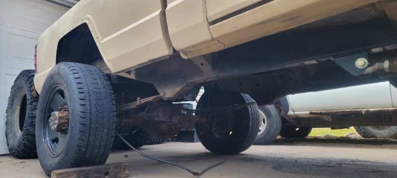

What you see is a rattle can camo tan paint job, newer body style doors, fenders and front clip, Ford 60 front and 10.25 rear on stock gearing, custom 3 link front end. Unibody plated from back of cab-forward and I'm guessing 8-10" lift? 4.0, aw4 and 231 tcase. Jeep has a 96XJ harness setup.

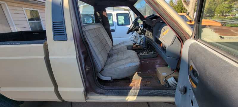

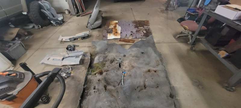

Junkyard haul recently
Carpet, bench seat, b pillar trims, seat belts

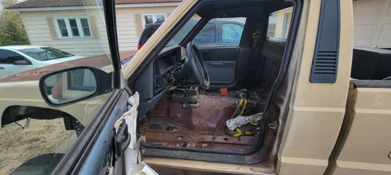

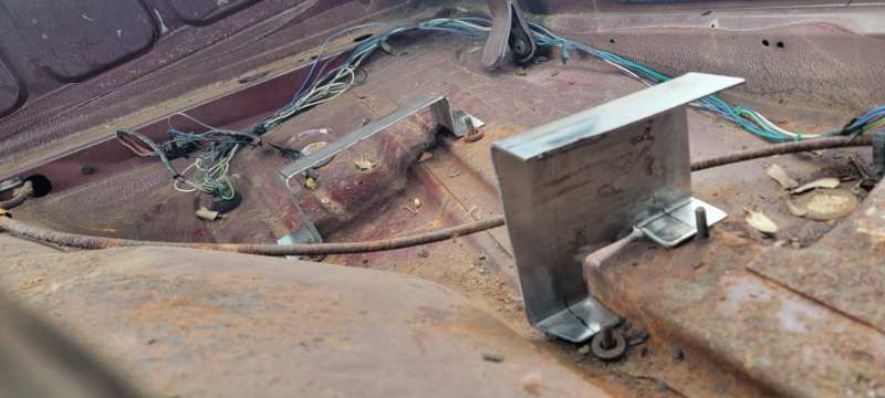

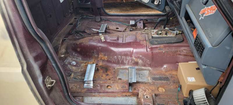

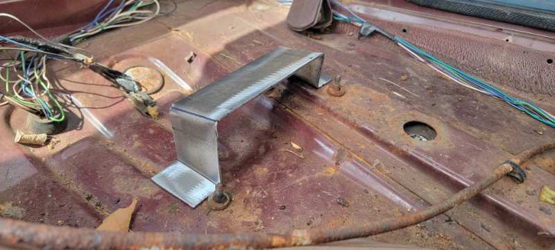

Naturally the seat mounts were rotten off soo i eyeballed with a tape measure and came up with my own mounts from leftover sheet steel.
My issue now is the seat mounts are too tall. Going back to the board on a 2nd set but for now she can atleast sit in it and make engine noises until I freshen up battery cables and a fuel system.
Yea I'm aware of them, but for the price and comparison to how close I have mine setup to where id like the seat - I'll make another set from more leftover material I have on hand
