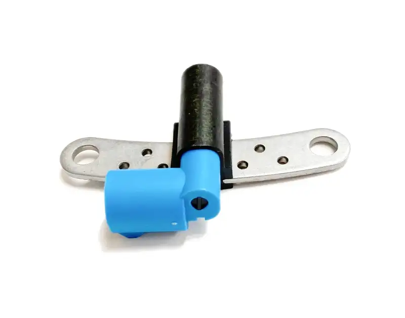

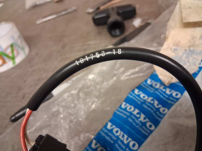

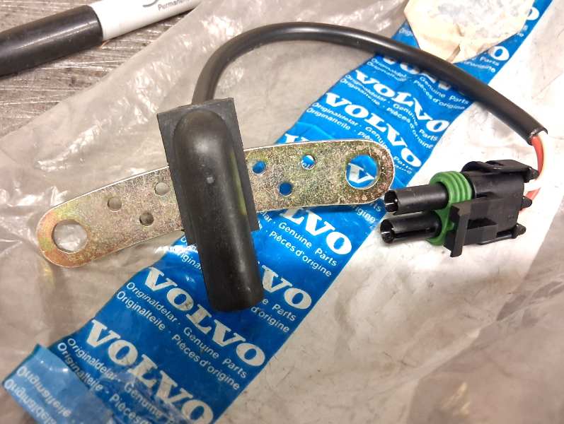

junkboy Posted Wednesday at 08:06 PM Share Posted Wednesday at 08:06 PM i don't know if this has been shared, but where the crank position sensor (cps) is obsolete from Mopar, i got thinking about renault. i searched up renix cps and this guy popped up. i ordered it and its the same CPS. ill have to test it on my machine, but its from a 2.5l volvo the ebay title is below. Cast into the top of the cps is "renix" I believe there are renault cps & volvo cps that can be found. VOLVO 480 CPS 101750-18 RENAULT STYLE Link to comment Share on other sites More sharing options...

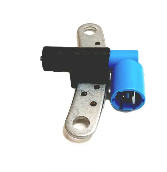

junkboy Posted Wednesday at 08:19 PM Author Share Posted Wednesday at 08:19 PM here is another option. it looks like there are a bunch that are this style, with different plugs. Link to comment Share on other sites More sharing options...

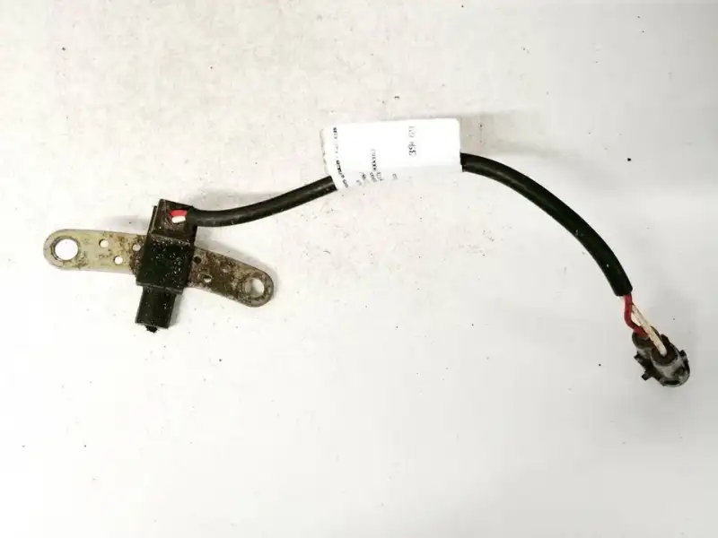

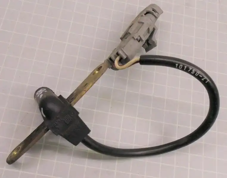

junkboy Posted Wednesday at 08:21 PM Author Share Posted Wednesday at 08:21 PM this one is from a 1998 machine. Renault Laguna 1998 Crankshaft Position Sensor 10175021, 101750-21 #2269980-09 Link to comment Share on other sites More sharing options...

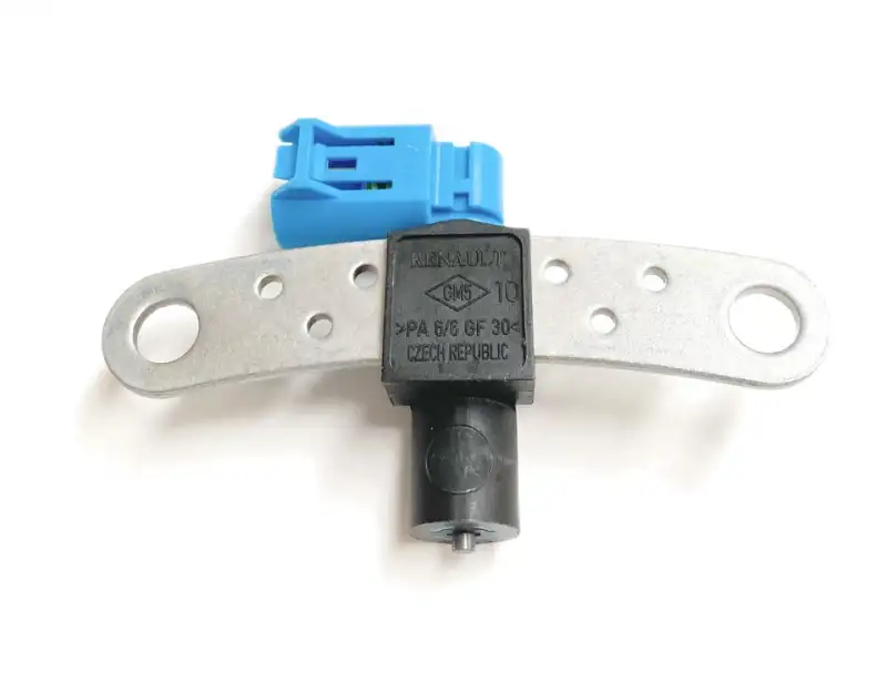

junkboy Posted Wednesday at 08:27 PM Author Share Posted Wednesday at 08:27 PM even this one would work, i believe, and you can still buy these directly from renault. they are not expensive. lee Genuine Renault Dacia CPS Crank Position Pulse Sensor 8200643171 Clio Megane Link to comment Share on other sites More sharing options...

eaglescout526 Posted Wednesday at 09:05 PM Share Posted Wednesday at 09:05 PM Some of the Renix or Fenix probably made it to Volvo cars. I’m not surprised that such has been found but given how often you don’t see Volvo cars around, it’s probably why no one thought to check their parts. Link to comment Share on other sites More sharing options...
Htchevyii Posted Thursday at 03:43 AM Share Posted Thursday at 03:43 AM 7 hours ago, junkboy said: even this one would work, i believe, and you can still buy these directly from renault. they are not expensive. lee Genuine Renault Dacia CPS Crank Position Pulse Sensor 8200643171 Clio Megane I saw a post in a Facebook forum once where someone was claiming that this style would work. I don't remember if it was ever proven though. Link to comment Share on other sites More sharing options...
hgeranium Posted 12 hours ago Share Posted 12 hours ago On 3/18/2026 at 10:43 PM, Htchevyii said: I saw a post in a Facebook forum once where someone was claiming that this style would work. I don't remember if it was ever proven though. I don't see why it wouldn't, right? The CPS itself is a pretty simple sensor Link to comment Share on other sites More sharing options...
