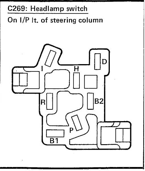

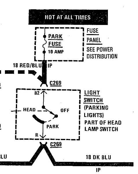

Gojira94 Posted February 10 Share Posted February 10 Try pulling the headlamp switch and testing for continuity from B2 to R with the switch in the park/ running lights position and the headlamps on position. I bet you get OL at the park position. Link to comment Share on other sites More sharing options...

thejeepmanwithcrocs Posted February 10 Author Share Posted February 10 So with the new switch in I still have the same problem. With the lights turned to the on position I checked my front left amber light with the bulb out and I have all ground no power. Is there a way to test the switch with the test light? Obviously I’m getting power. Headlights are on. But what’s blocking the power to the taillights? Link to comment Share on other sites More sharing options...
87MJTIM Posted February 10 Share Posted February 10 Do you have the 88 electric manual? Link to comment Share on other sites More sharing options...
thejeepmanwithcrocs Posted February 11 Author Share Posted February 11 I have the manual now. Thank you. Sadly it’s hard for me to wrap my brain around this stuff. I’m trying I really am. Just feeling slightly discouraged just because of a lack of knowledge on how these things work lol. I’m gonna do my best to study this maybe it can lead me in a good direction. Link to comment Share on other sites More sharing options...
