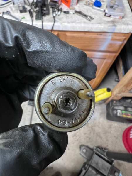

Doc Payne Posted February 16 Author Share Posted February 16 Wanted to update this as I’ve found the issue, and have yet to come across a similar post with it. Here is the injector I pulled out. Someone had unscrewed the center post screw and this was allowing excess fuel flow. I screwed it back in and the rich smell was gone, and the O2 sensor started fluctuating between 0-1v as it should. I ended up replacing the injector since I wasn’t sure on the calibration anymore. I went with a GM TBI injector from a 1990 s10 Blazer 4.3L V6. All seems to be well now! I did also have a faulty MAT sensor. The wires had started to fail where they enter the sensor and when I wiggled them a bit, the resistance went to open. So I drilled out the intake manifold hole to 9/16” and tapped with a 3/8 NPT. Used a GM air charge temp sensor (Standard motor products AX1) and it functions perfectly. Other notes for the next guy to come through. The 2.5l does not have a 5v reference at the O2 sensor connector output wire (gray on the 1989) like the 4.0 does. The 2.5 sensor only puts out a 0-1v signal when running. Link to comment Share on other sites More sharing options...
