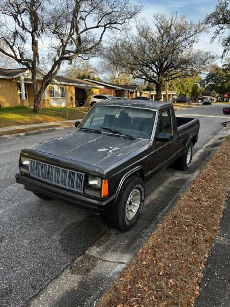

MJThadUSAF Posted January 23 Posted January 23 So, recently went on the good ole dash-completely-out new heater core journey. Not as bad as I thought. Neighbor and I got it done in an afternoon! However, now I need to figure out how to get my blend doors working, When I adjust the temp or vent mode on the climate control panel my blend doors don’t move at all. I see those black and white vacuum hoses running from the climate control are disconnected as well. Can anybody help with this? I need some major guidance, haha. 1989 Pioneer, 4.0, 2WD, pretty sweet ride.
