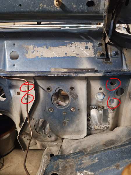

A-man930 Posted Sunday at 05:09 AM Share Posted Sunday at 05:09 AM I've had this thing apart for so long that I can't recall what these holes are for. I'm considering plugging them. Cruise control? Link to comment Share on other sites More sharing options...
eaglescout526 Posted Sunday at 05:24 AM Share Posted Sunday at 05:24 AM Two on the left are for throttle cable and speedo cable Two on the right are for hood release and I think the other is for the washer hose to the rear hatch on an XJ which would be plugged in an MJ. Not sure what else would go through that side of the firewall aside from the clutch master and hood release. Link to comment Share on other sites More sharing options...
A-man930 Posted Sunday at 08:47 PM Author Share Posted Sunday at 08:47 PM 15 hours ago, eaglescout526 said: Two on the left are for throttle cable and speedo cable Two on the right are for hood release and I think the other is for the washer hose to the rear hatch on an XJ which would be plugged in an MJ. Not sure what else would go through that side of the firewall aside from the clutch master and hood release. Looking a little closer, I can see my Sharpie labels under the overspray - the square hole says throttle, and the top one next to it says cruise. I'm guessing the other is speedometer. For the ones next to the clutch master, I had totally forgotten about the hood release cable. Thank you! Link to comment Share on other sites More sharing options...

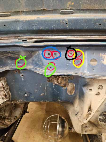

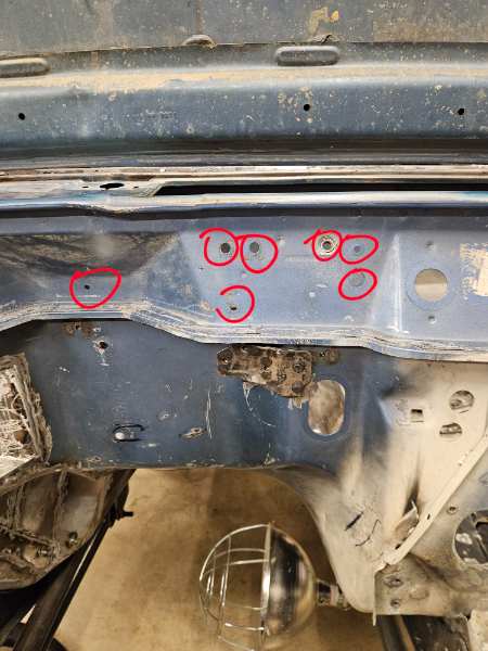

A-man930 Posted Monday at 02:52 AM Author Share Posted Monday at 02:52 AM Ok, this is somewhat a case of me being too lazy to clamber into the attic and dig up the wiper linkage, but what are these for? Link to comment Share on other sites More sharing options...
GonzoTheGreat Posted Monday at 04:02 AM Share Posted Monday at 04:02 AM Green is wire loom clips Blue is wiper bracket/MAP Yellow I think is the bracket that holds the plastic screw receiver for the wiper cowl Black is engine grounding ribbon Link to comment Share on other sites More sharing options...
A-man930 Posted 18 hours ago Author Share Posted 18 hours ago On 12/28/2025 at 10:02 PM, GonzoTheGreat said: Green is wire loom clips Blue is wiper bracket/MAP Yellow I think is the bracket that holds the plastic screw receiver for the wiper cowl Black is engine grounding ribbon Many thanks. I'm glad I asked because I was about to close up the yellow ones! Link to comment Share on other sites More sharing options...
