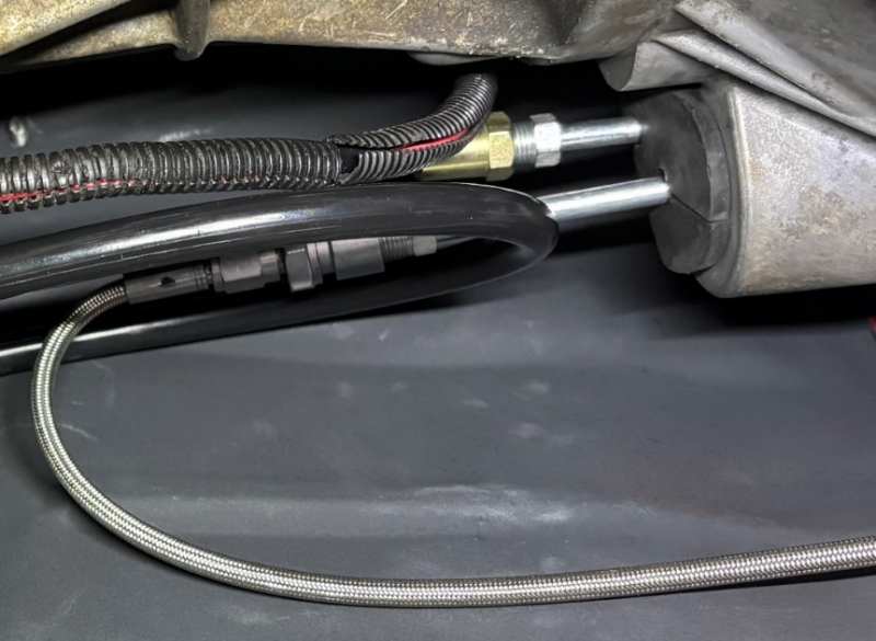

Gojira94 Posted November 19 Share Posted November 19 I just went out to the garage to get started bleeding the clutch. Doing that would put me one good nut and bolt session from driving my project for the first time. But no. F no. The bleeder did NOT want to come out. Not at all. I got it to crack loose and it was tight all the way off and I wanted to see why. The orifice end looks bad and there was some sort of residue on it. Cleaned it off and tried to screw it back in but it was still tight. So I thought "I'll go find another bleeder, and pull off the fitting it goes into and clean that out for peace of mind." That piece also did not want to budge with very heavy force. The bleed line bent and I heard the unmistakable sound of the retainer dropping off the roll pin that holds the slave in place and into the bottom of the bellhousing. See pic below of the bleeder screw and the (old) roll pin retainer to locate the slave: My questions are: 1) how critical is that retainer being in place? 2) should I risk cleaning out what the bleeder goes into with solvent and a q-tip, cross my fingers and hope for the best? Or, would I be better off yanking the drivetrain and putting a new slave in it? PITA but I'm not opposed to it. Thanks Link to comment Share on other sites More sharing options...
Gojira94 Posted November 19 Author Share Posted November 19 This is what I started with: Link to comment Share on other sites More sharing options...

Gojira94 Posted November 20 Author Share Posted November 20 9 hours ago, pizzaman09 said: Have you been having issues with your clutch actution? I'm guessing there was a reason you wanted to bleed it. I was finally getting ready to actually use the clutch for the first time. This was the last thing it needed to run and drive. It hasn't moved under its own power since 2017, according to the NC Emissions Inspection Unit. I can't get the bleeder/ fitting off the bleed line, and it's bending and very not happy. Slave is trash, I'm calling it and yanking the drivetrain. Looking for another slave now. Link to comment Share on other sites More sharing options...

Gojira94 Posted November 22 Author Share Posted November 22 Ahhh, ok. You meant during your conversion. Understood. I had some success yesterday. I’ve got more than enough clearance underneath and a trans attachment for my 3-ton jack. i separated the trans just enough to get the slave out. I popped off the bleed line with an old fork/ wrench clutch tool. I got the bleed fitting off, cleaned the threads up and dug out a brake bleeder of suitable size from my toolbox. I’m satisfied enough with it to give it an go and try to bleed it before I put it all back together or look for another slave. All i need from this one is to last until next summer. By then I should be in a position to do the conversion like you did. Link to comment Share on other sites More sharing options...
