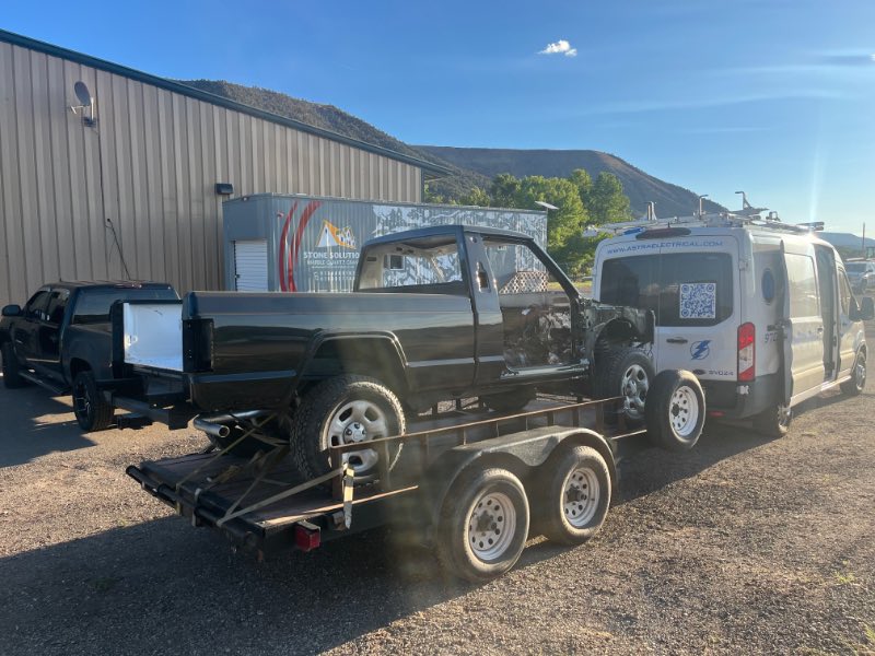

Elwiscon Posted September 22, 2025 Share Posted September 22, 2025 Help! Finally got the truck back from the paint shop, I was able to start it, drive it on and off the trailer back into my shop. A couple days ago the 6 year old battery started having issues (low charge), which is expected. Yesterday I attempted to jump start it, and, (yes i screwed up) I connected the jumping cables backwards, noticed it when I heard and saw the sparking, connected it again, this time with the correct polarity. Then i tried starting it, no crank, no big deal I thought, need a new battery. I replaced it this morning, same issue, no crank when i attempted starting it. I checked the fuses under the dash, didn’t find any blown fuses, I will do other tests when I get a chance. What could it be? A)——-Damaged ECU? B)——damaged starter relay*? C)——fusible links? D)——starter*? E)——-Ignition coil*? F)——-all of the above? *parts less than a 1 year old Truck was running better than ever, smooth start, idling, throttle response, etc. Did the Jeep Cables replacement under the hood, refreshed grounds etc and it has worked great until I screwed up (damn!!) Truck isn’t drivable as I have the interior taken apart but everything else works as expected. Hopefully someone can point me in the right direction? Don’t want to waste a lot of time troubleshooting this but need to get it fixed before I re assemble the body and interior. Thanks! 1989 4.0 manual comanche Thanks Link to comment Share on other sites More sharing options...
