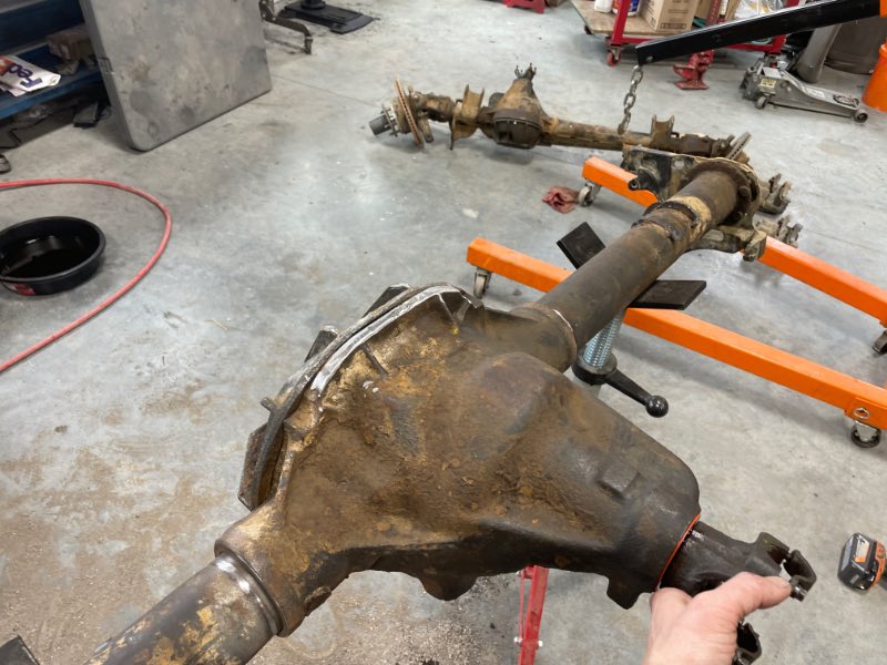

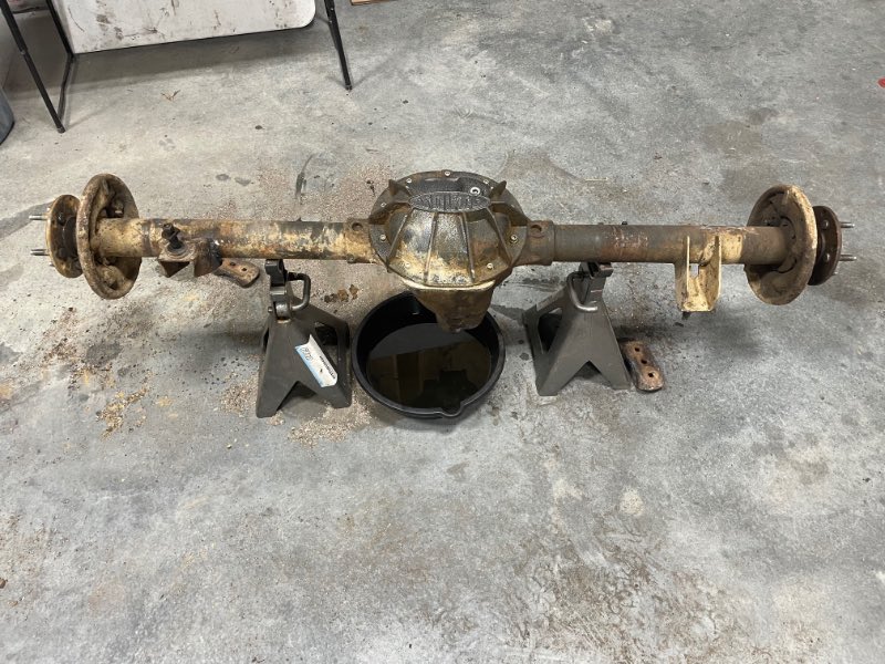

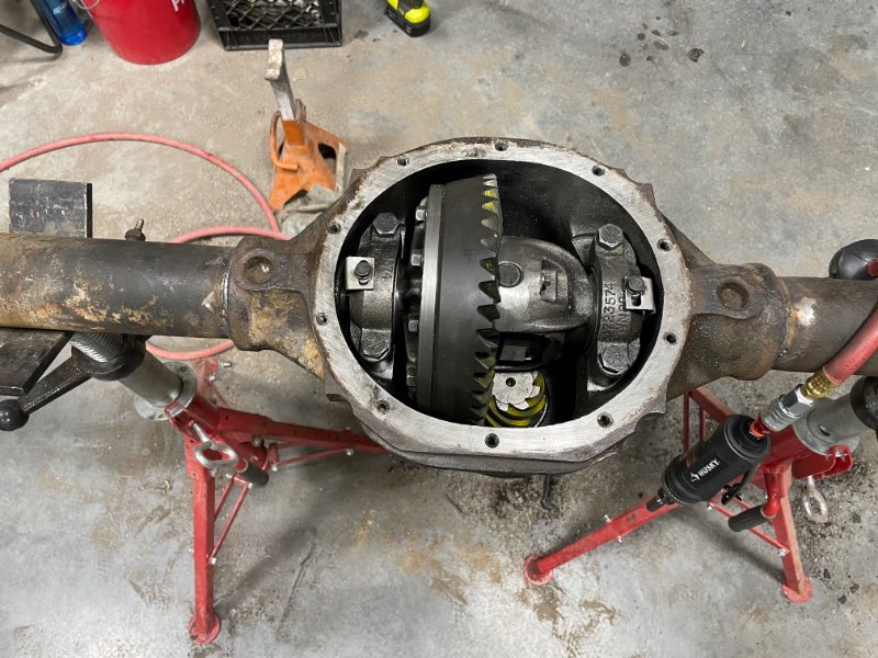

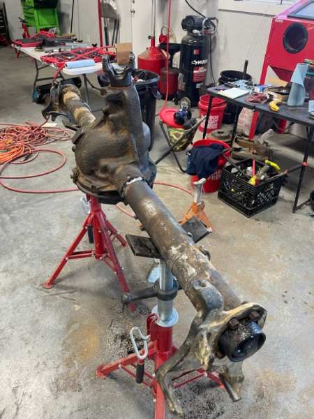

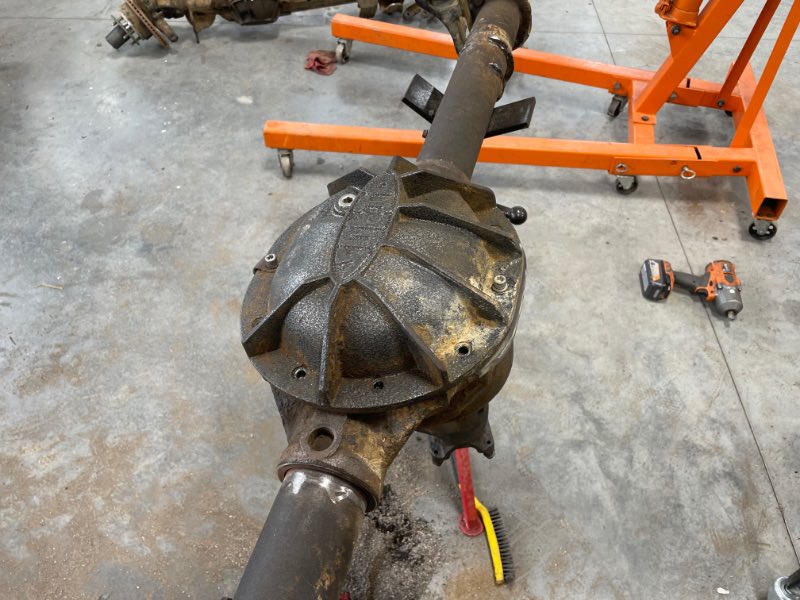

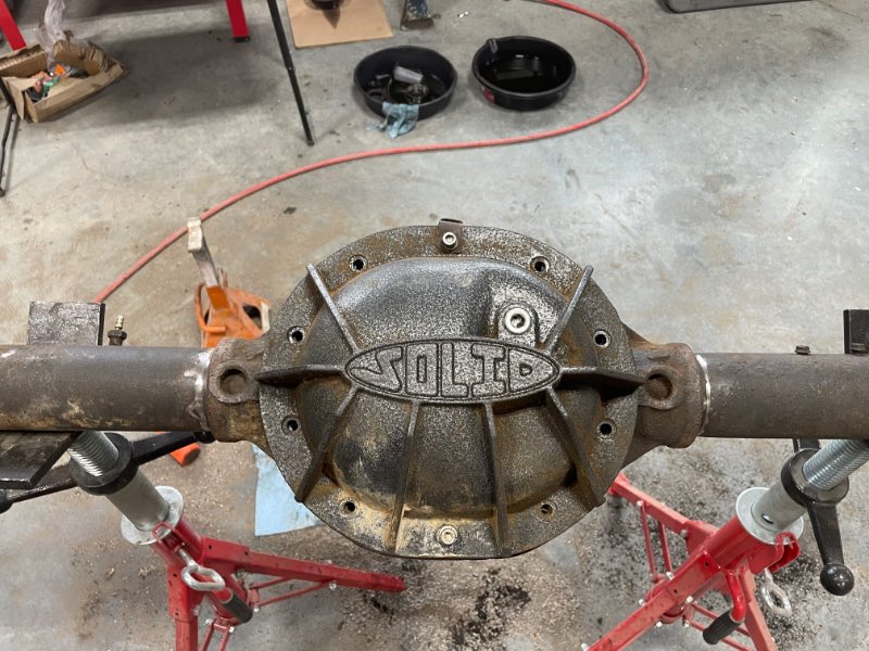

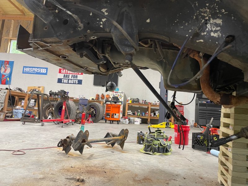

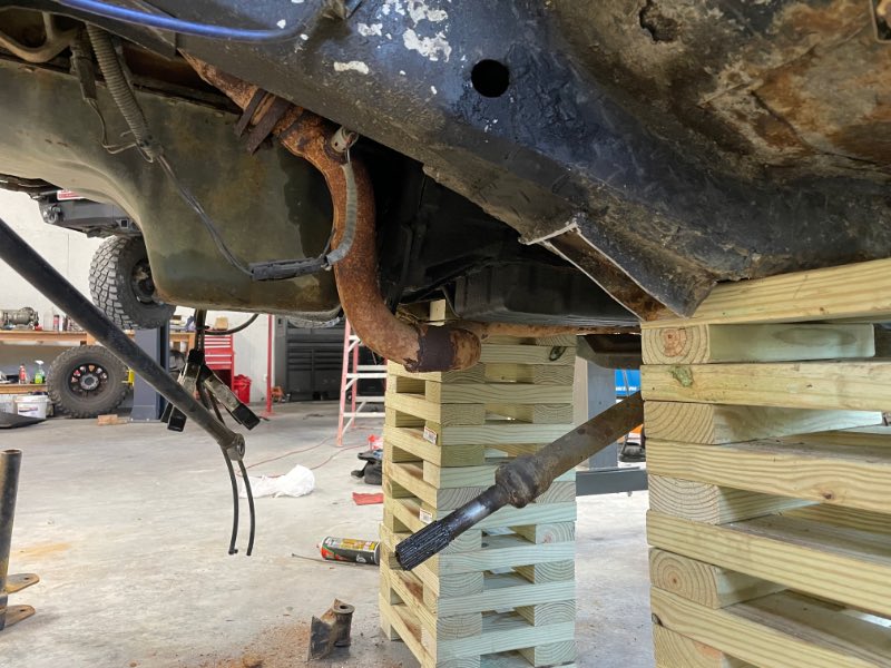

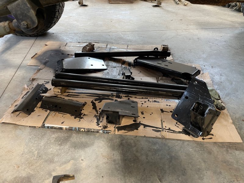

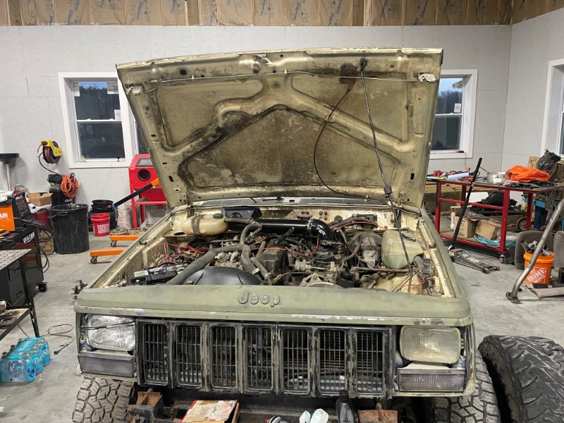

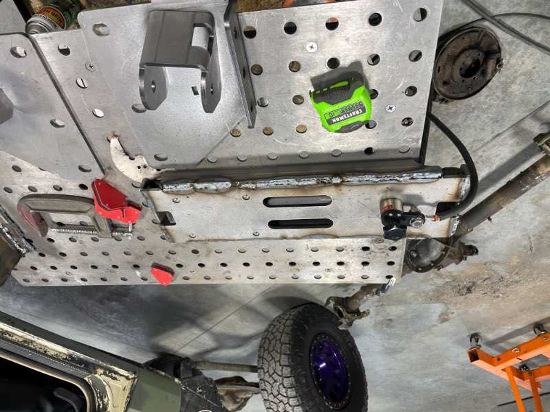

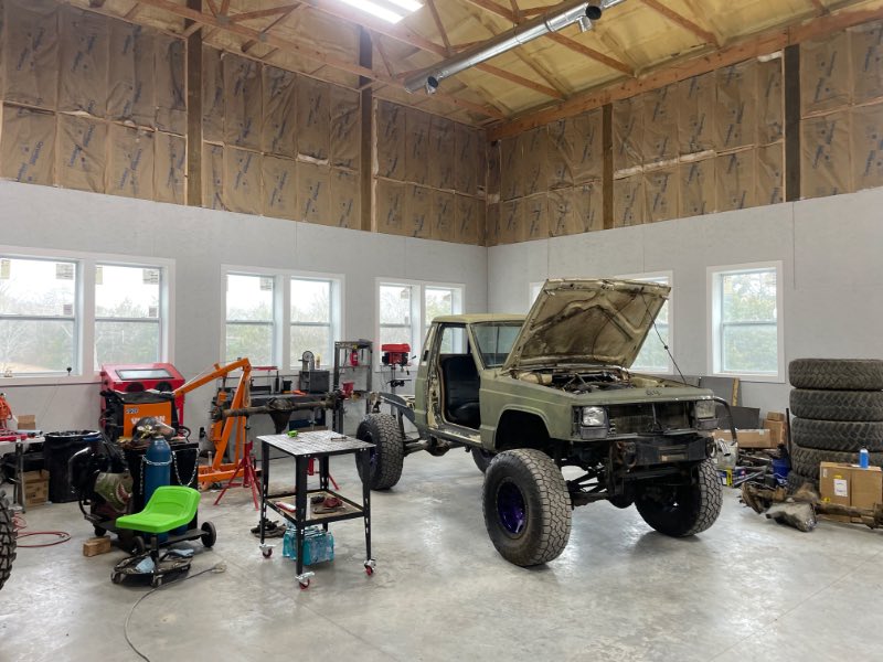

Been making more progress, I’ve got the 8.25 rear re-geared, disc brake brackets on, bottom lip shaved, and ready to weld the tubes and replace the axle seals (hopefully tomorrow). Once that’s done both axles are prepped to go under the truck.
Before:
IMG_8047.jpeg.506b88708d893f5c956061dd67eea093.jpegIMG_8035.jpeg.f4b9dee288049141fd60b0eb385d408e.jpeg
After:

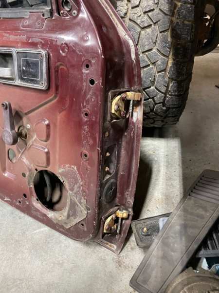

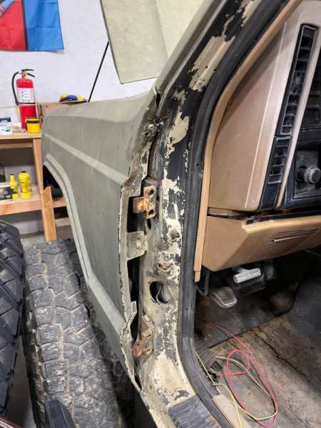

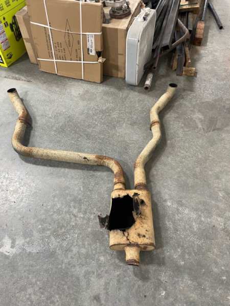

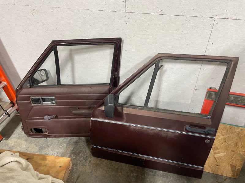

I cut off the old exhaust with the blown out muffler, and got a universal Walker from rock auto I’ll make fit. Cleaned up the doors I have and started modifying hinges on the truck so they’ll be removable.
I ordered the hydro bump kit and mounts from Iron Rock Offroad. I think this will be the best and easiest solution for getting my front reset for coil springs, plus some air bumps in the front is really nice on the trail.
Feels good to be getting to some fun stuff.

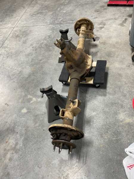

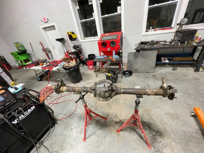

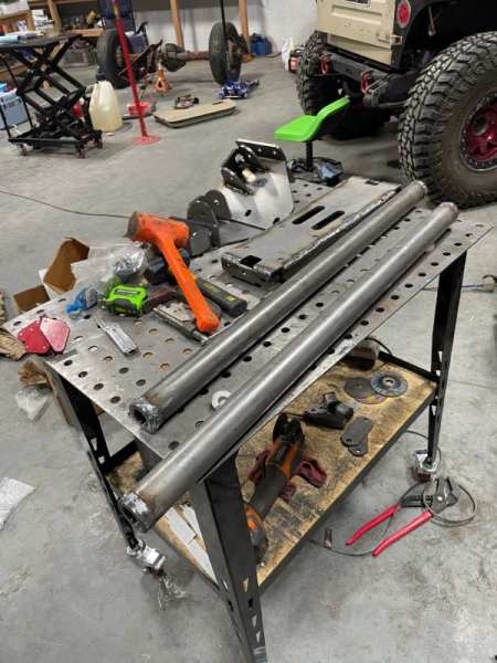

Got the tubes welded, axle bearings and seals replaced, and everything back together. Both axles are geared to 5.13 and ready.
IMG_8179.jpeg.987b4b5a60ac60fc7efe0a4786c766ce.jpegIMG_8181.jpeg.40a91506e176059cf73af3256e53d442.jpeg

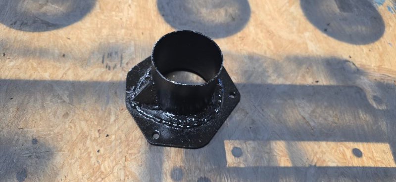

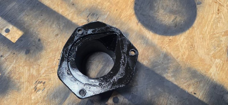

I also got the RENIX throttle body adapter made for when I’m ready to get my THOR cowl intake in, and worked on getting my doors set up.
