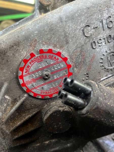

JRam Posted June 6, 2025 Share Posted June 6, 2025 good morning, I have a 1992 Comanche that I’m getting ready to do convert from 2WD to 4WD. When I purchased the Manche the dude threw in another transmission and transfer case. I just want to verify that this is the year that I need. I checked the factory service manual and all it said was to use the info on the plate when ordering parts. I’ve done the conversion on my Cherokee with no issues. thank you for any assistance you can give. Link to comment Share on other sites More sharing options...

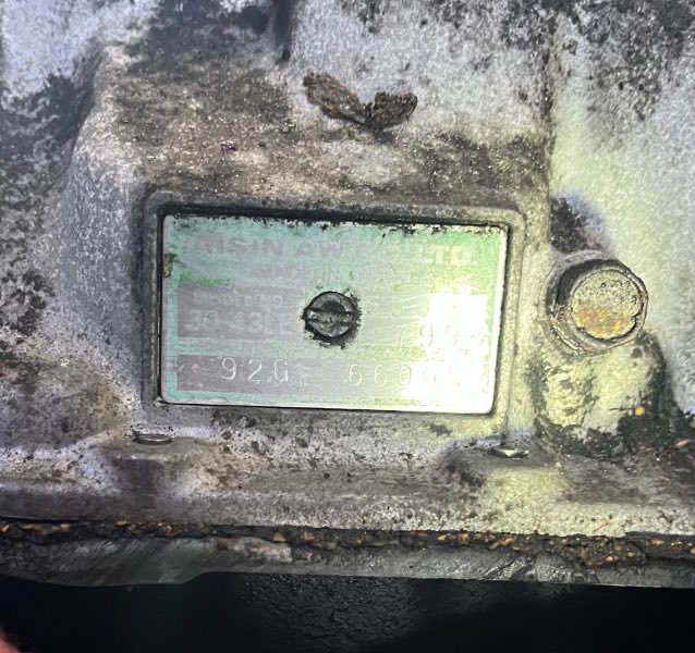

Pete M Posted June 6, 2025 Share Posted June 6, 2025 is that first pic of your current 2wd transmission? Link to comment Share on other sites More sharing options...
JRam Posted June 6, 2025 Author Share Posted June 6, 2025 No, it’s the 4x4 transmission Link to comment Share on other sites More sharing options...
Pete M Posted June 7, 2025 Share Posted June 7, 2025 oh, I see now. I knew I read somewhere that that's the model number of the 2wd version, but more research shows that Jeep used it for both 2 and 4wd at times. once you find out which year it is, this thread will help out. near any year can be used with some extra work. https://naxja.org/threads/everything-you-ever-wanted-to-know-about-the-aw4.1053970/ Link to comment Share on other sites More sharing options...
Eagle_SX4 Posted June 7, 2025 Share Posted June 7, 2025 The transfer case was made on October 8, 1990. (The serial number is also the build date) Link to comment Share on other sites More sharing options...
