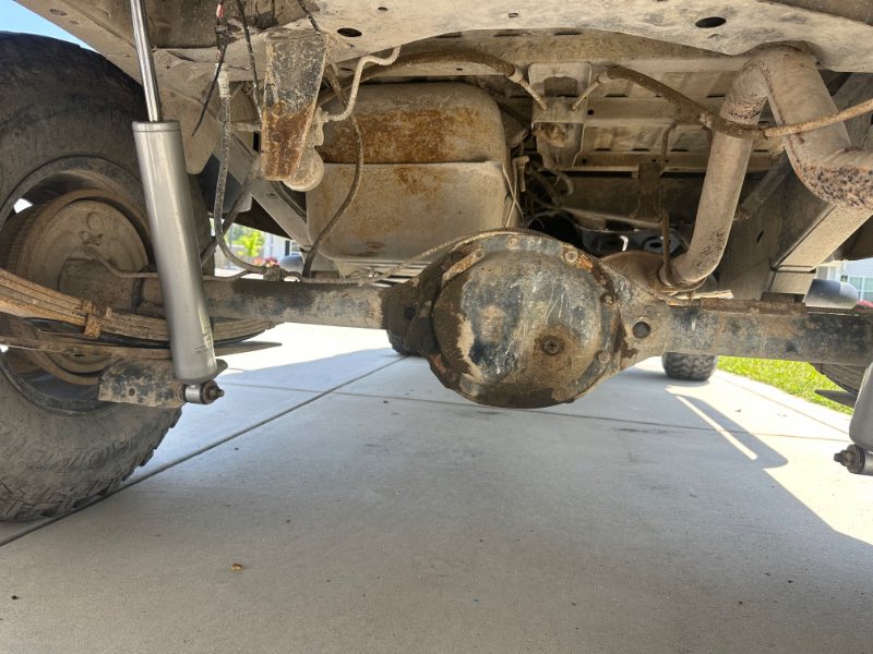

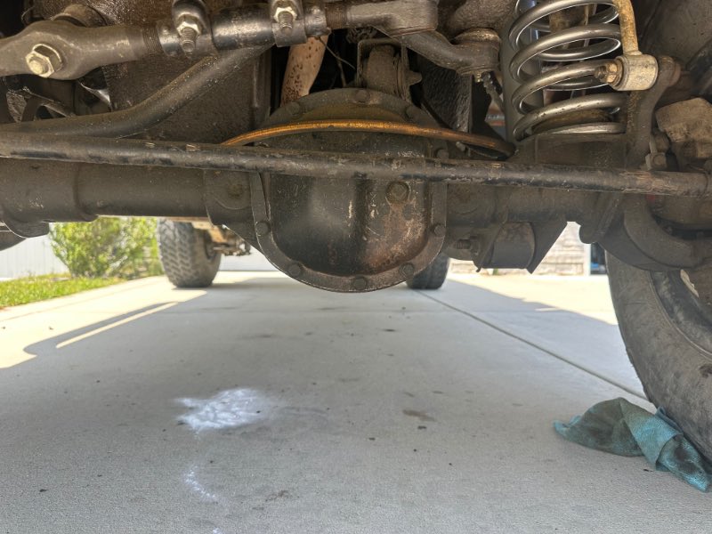

Cami.1987 Posted May 30, 2025 Share Posted May 30, 2025 Hey all, New to my 87 Comanche (4.0L, 4x4, 5 Speed, Short Bed) and am trying to figure out what diffs I have. After reading through some posts and pictures, I’m pretty positive I have a D35 in the rear, but it looks like a D44 in the front? Am I crazy? Is this a thing? Unfortunately the previous owner didn’t know much about her. Thanks in advance!! Front Rear Link to comment Share on other sites More sharing options...
eaglescout526 Posted May 30, 2025 Share Posted May 30, 2025 D30 for the front. D44 front wasn’t a factory option. Link to comment Share on other sites More sharing options...
Cami.1987 Posted May 30, 2025 Author Share Posted May 30, 2025 Thanks @eaglescout526! Shows my unfamiliarity with these kinds of things. I was referencing some of the diagrams from other posts but I didn’t consider the D30. Thank you again!! Link to comment Share on other sites More sharing options...

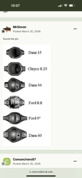

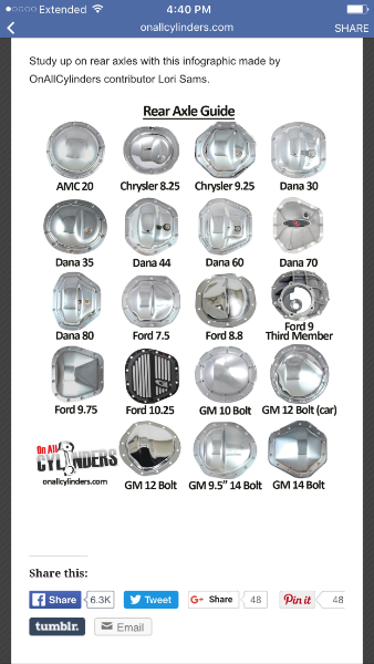

89 MJ Posted May 30, 2025 Share Posted May 30, 2025 This is a good reference I’ve had saved for years. Link to comment Share on other sites More sharing options...
