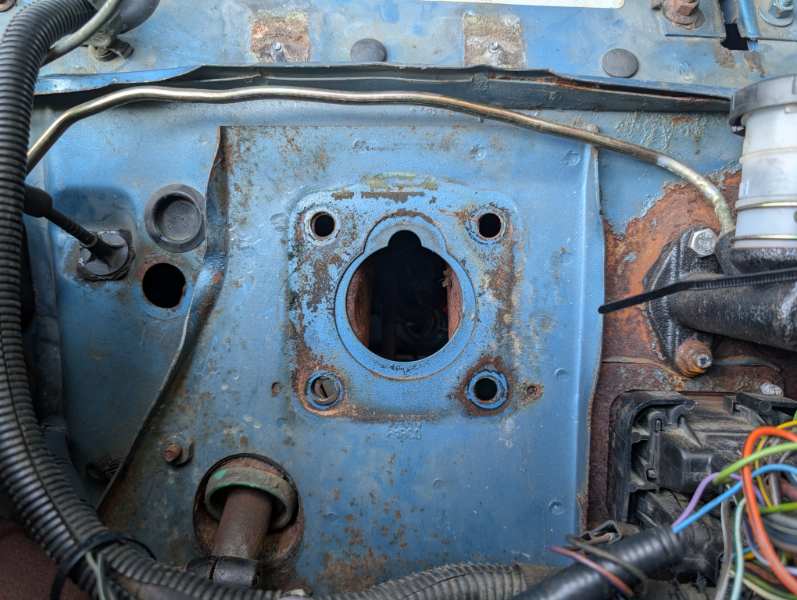

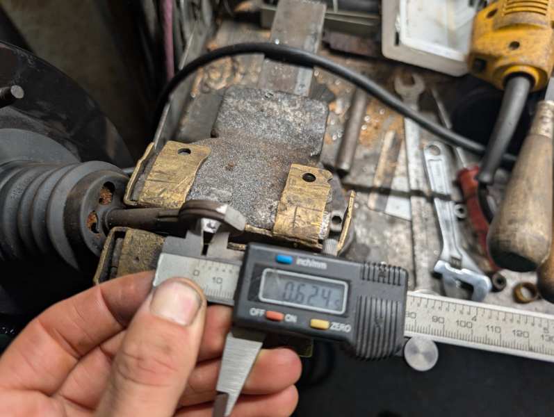

I had 2 major brake issues that came up at the same time, so I went to the junkyard, loaded up on parts and tore into it earlier this week.  Good excuse to upgrade.

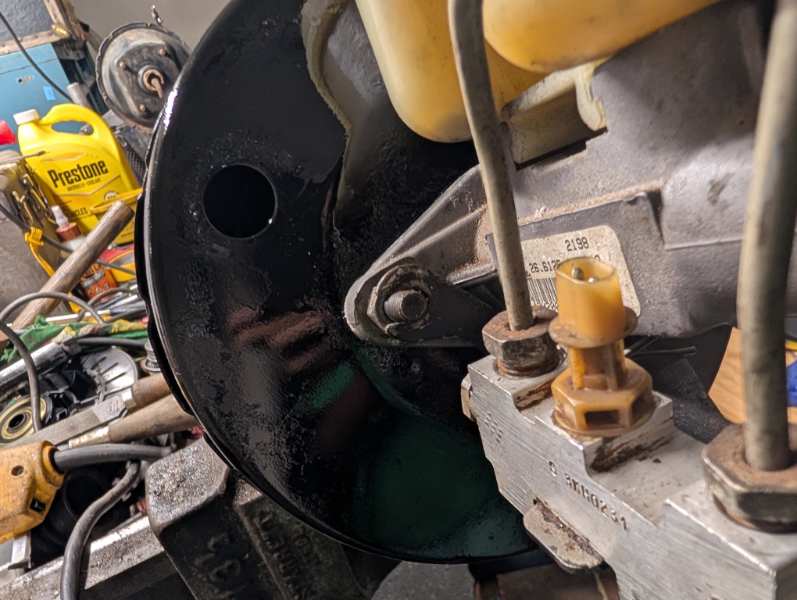

My booster was leaking (drawing air through the pedal side), and the combination switch ( proportioning valve looking gizmo) was also leaking a lot of brake fluid THROUGH the plastic threads for the switch. I initially was going to simply replace the o-rings in the combo valve, but couldn't get any in the correct material on island without waiting for (possibly) another month. The hydraulics store I went to checked the o-ring sizes off a chart (they didn't actually measure them) but said they were the following sizes:

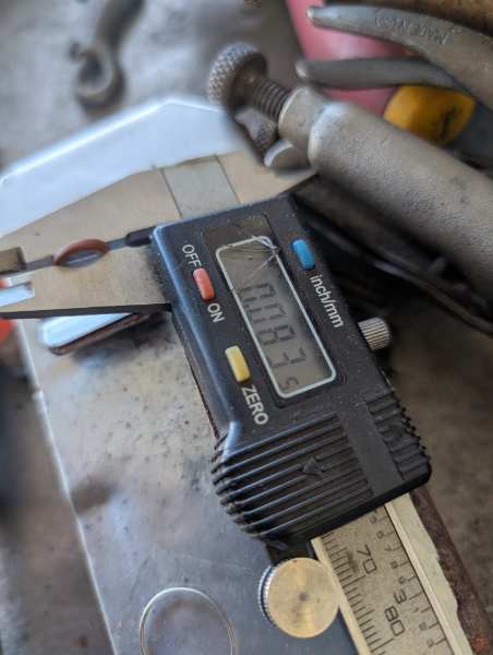

Additionally, they MUST BE EPDM. Not Buna, Viton, etc. Take those sizes listed above with a BIG grain of salt as the girl behind the counter had NO idea what EPDM was, which surprised me seeing all of the seals / o-rings etc that they DID have.
Anyways, since they didn't have the right seals, I instead bought a dual diaphragm booster from a 2000 WJ Grand Cherokee (this one was a 4.0 with ABS, don't know if it makes a difference).  I also used the master cylinder from the WJ, however got a proportioning valve from a late model XJ (2000??).  I removed my stock, load sensitive proportioning valve, and removed the 'return line' that goes into the nose of the stock combination valve.  There are two modifications you have to do to make the stock brake lever/brake light switch work with the WJ booster, which is to drill the booster pushrod out to 5/8", and a flat needs to be filed on the end of the pushrod to make the light switch work.  The distance from the EDGE of the 5/8" hole to the flat is 0.115" I know some folks grind this, but I would caution against grinding as some of those same people took too much off, or said their lights still didn't work (again, either uneven, too much removed, too little removed etc).  It took me AT MOST 5mins to file it flat by hand.

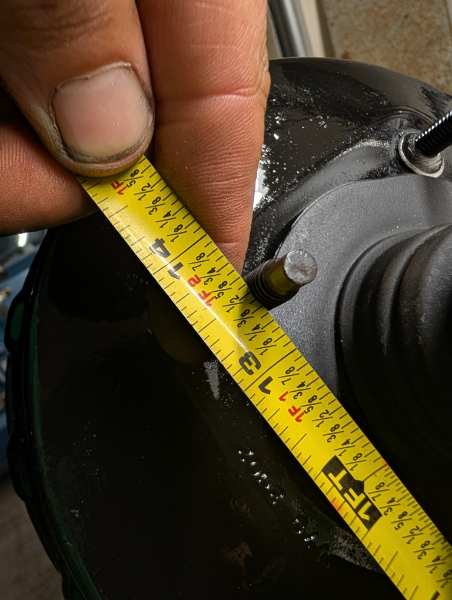

The XJ proportioning valve bracket will fit on the WJ master cylinder if the holes are cut into slots:
The booster hole pattern on the XJ is SLIGHTLY different from the WJ (MJ=3-3/8" WJ is probably ) however the fact that the WJ booster has smaller studs (WJ-M8 vs MJ-3/8") means the studs on the new booster still slide through through the stock firewall holes.  The pinch seam above the booster AND to the sides need to be massaged to clear the WJ booster.  I over massaged the passenger's side initially.  Oops.
At first, the master cylinder, which is pretty tall looks like it will hit the hood, but it does not.  I believe the WJ push rod is ~1/8"-3/16" longer that the MJ pushrod, which combined with the brake lever mechanical advantage, makes the pedal sit a bit higher than stock (~3/4" higher than the clutch pedal?).  Not too bad, but not level with the clutch pedal like I'd have expected.  Some washers or a spacer between the booster and the firewall would fix it.  I may fix it later; I'll see if it bugs me much driving.
In summary, the brakes work GREAT.  Way better than the stock, correctly bled setup.  The fronts lock up before the rear, and it feels well sorted out.  (And I don't have do to that crazy MJ bleeding procedure ever again!!!)

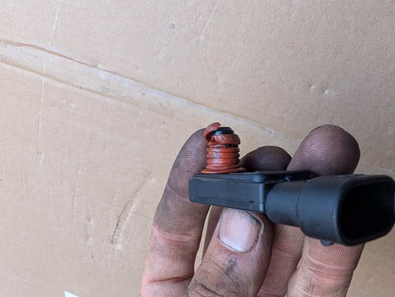

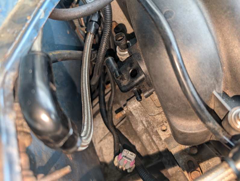

Been troubleshooting a few rough running issues, found 3 vacuum leaks!!

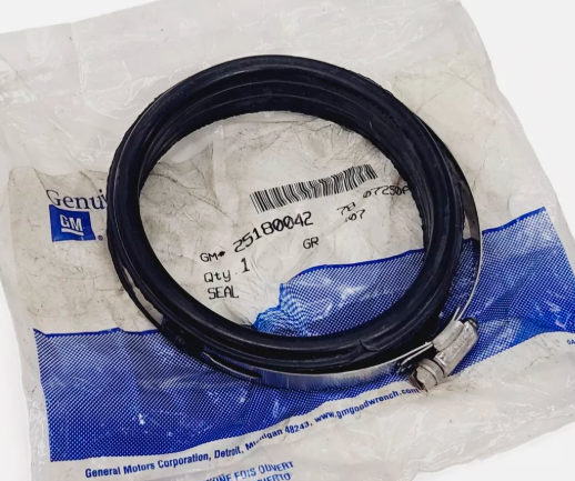

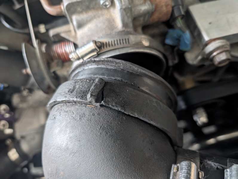

1. The intake boot from the MAF sensor to the TB was maybe oil soaked from it's previous life and the rubber got kinda gooey and split. (GM PN: 25180042).  The original boot is bonded to the plastic intake tube, however after it's pried/cut off, the new boot is sandwiched on and it's all held tight with the hose clamp.  Different than the original design, but seems to be working fine.

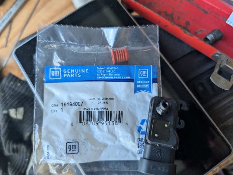

2. MAP sensor seal was ripped AND the little 'barbs' were all compressed on one side. It was VERY loose in the intake. (GM PN 16194007 for the LS1 intake)

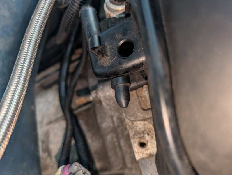

3. I completely missed blocking off this unused port until I replaced the MAP sensor seal.  Oddly enough I found a rubber cap IN MY DRIVEWAY that I have no idea what it came off of but it fit perfectly on.

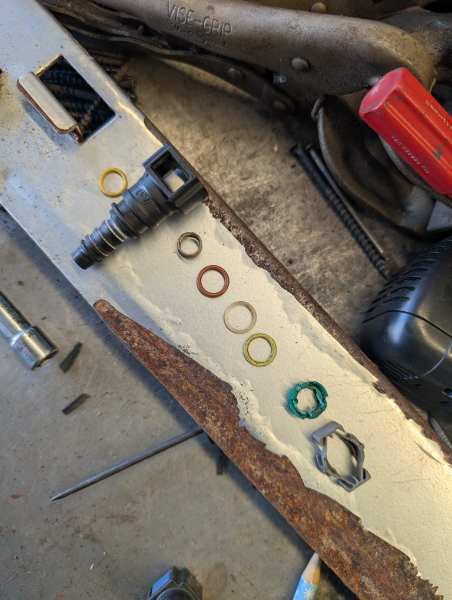

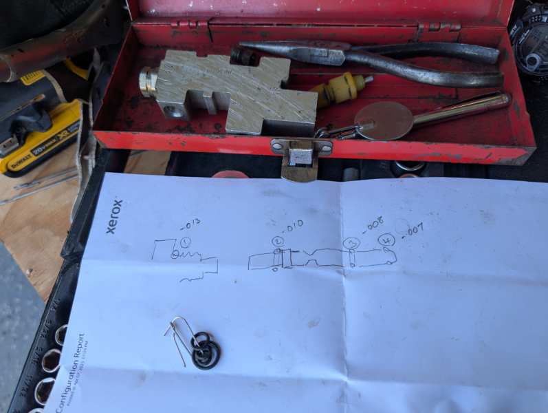

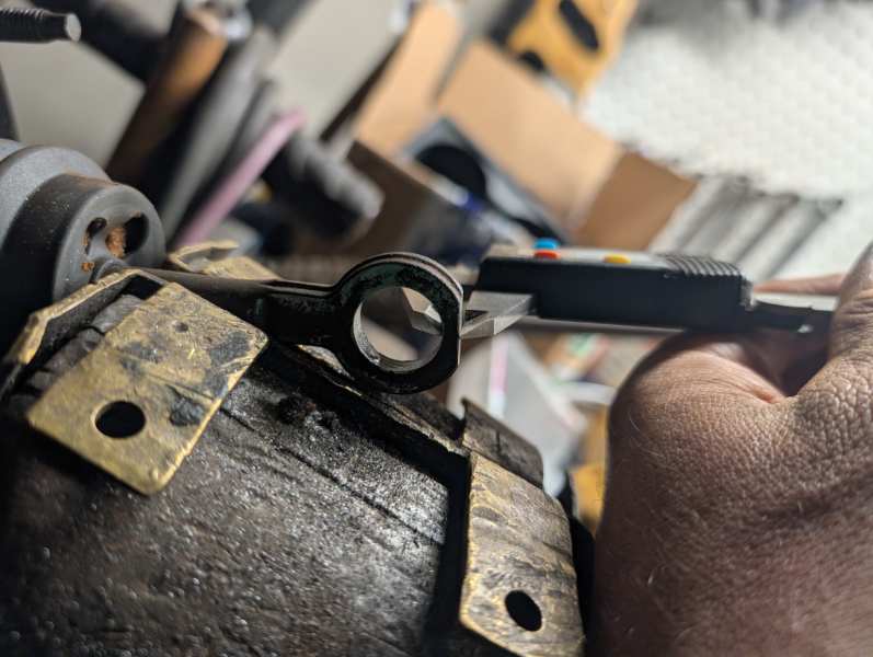

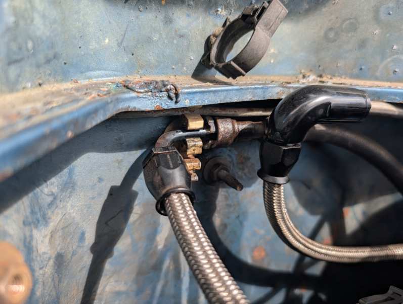

A few weeks ago I got a fuel leak behind the intake manifold, turns out it was the Jeep quick disconnect o-rings.  Of course, nothing available at Napa, or any other local parts stores (are you noticing a trend here??) but I had a few quick disconnects I had salvaged over the years that just HAPPENED to have the right size seals in them. Talk about lucky.

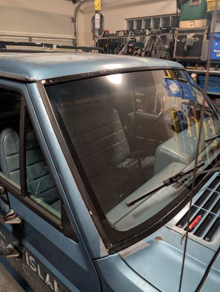

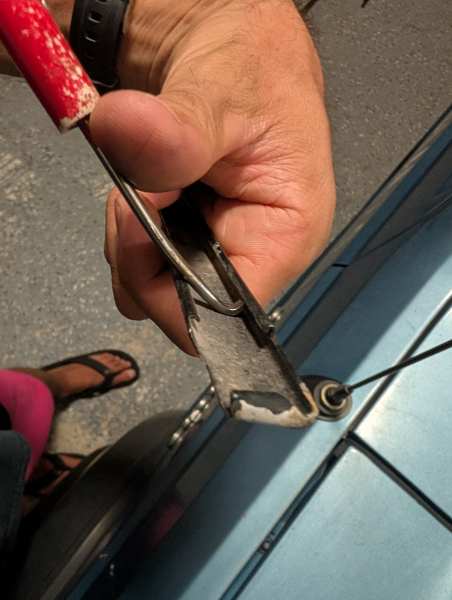

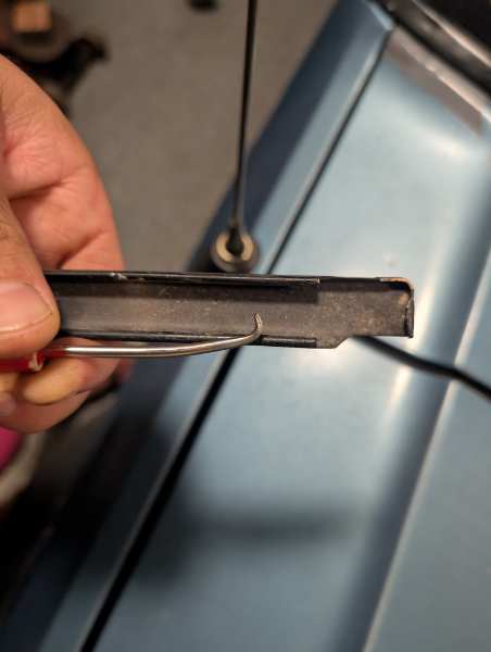

Finally put my windshield trim back in place!  Shout out to @ghetdjc320 who travelled thousands of miles to bring me this trim!
The stock trim snaps in place on plastic clips, but somewhere along the way, when I was straightening out the bends/dents in my original trim, I flattened out the little hook/ bend which mates to the plastic clips in the sheetmetal trim.  A little heat on a promotional screwdriver and now I have an odd trim tweaker.  Just one more in the big box of weird custom tools.

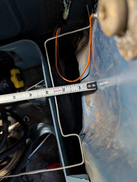

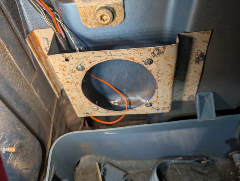

Got my subwoofers in and rear speakers installed.  Makes that stock AMC radio sound better than it is!  I had some 4" Panasonics which someone had put under the dash (poorly), so I put those in the b-pillar trim.  In the doors, I put in some speakers (Boston Acoustics??) from some home speakers, and the subs are no-names that I picked up in high school.  To put it into perspective, I graduated in 2003, so they're, like a fine wine, "well aged".
Seeing how long it took to make a simple sheetmetal bracket, I would suggest if you've got $40 kicking around to just purchase the brackets that are made by one of our fellow MJ'ers, but I had some sheetmetal, and it wasn't a bad project, just a time sucker.
Bent wire template showing rear clearance. I took off 3/8" but still didn't have to cut into the Jeep sheetmetal for the magnet clearance.
Yes, of course I used a rusty desk drawer I found on the side of the road for these brackets.  And no, I did not paint them.  If it rusts away inside my truck, I will have bigger issues to worry about.
I'll post up the sketch out of my notebook with dimensions, should someone else also want to waste a bunch of time making their own speaker brackets :)
Kinda funny that AMC had the wires there, the original stereo has a R/F fader knob, but they never bothered to put in the rear speakers or brackets.

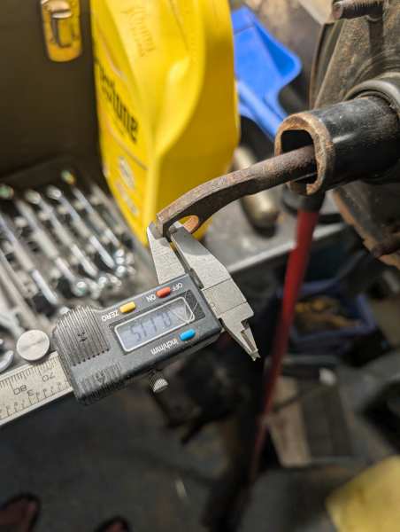

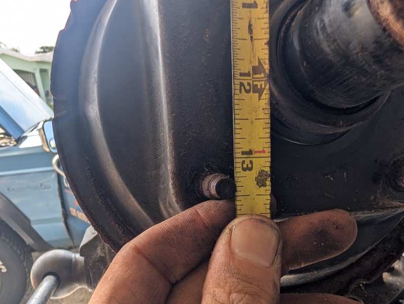

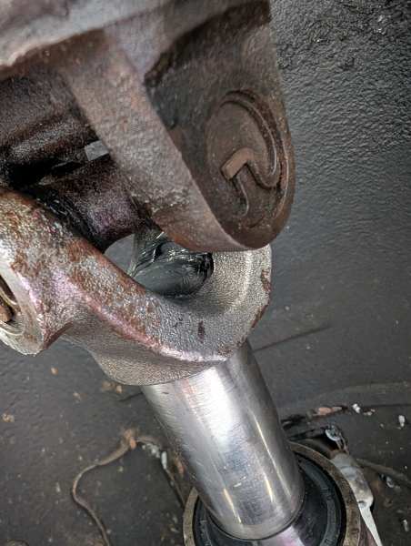

Never would have thought of a leak here.  (Where the welch plug is pressed into the slip yoke.)
I think I have to revisit the RTV again (it's not 100% stopped leaking) with the driveshaft removed so I can goop the sealant in there better, or maybe use JB Weld if I can clean it well enough.

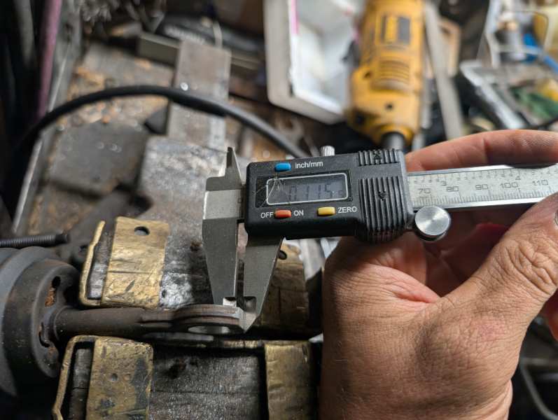

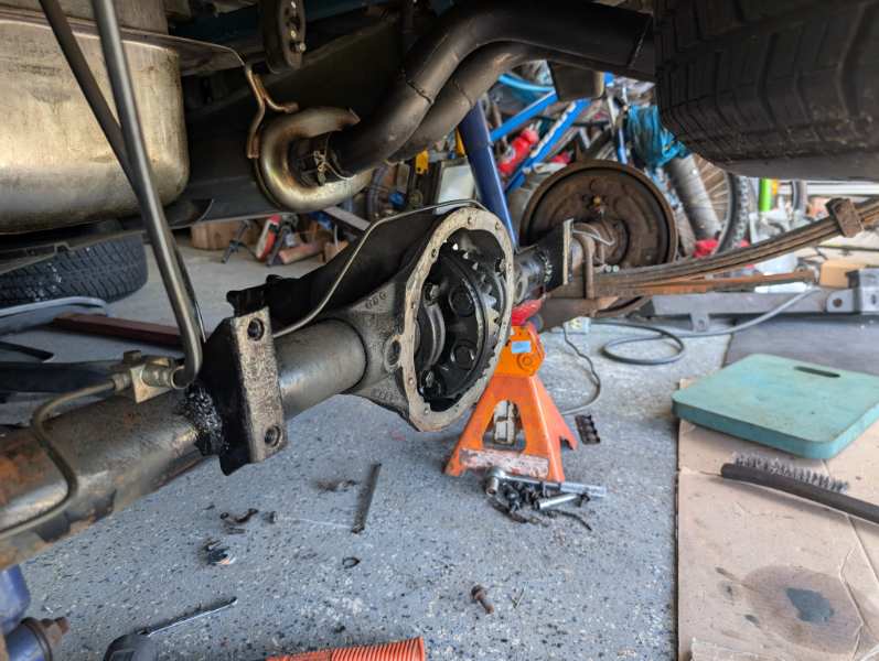

Rear end's noisy and leaks at the pinion seal with 3.08 gears (meh). Found a set of gears on a '94-ish Grand Cherokee in the forest, so I pulled them, along with the Spicer Trac Lok carrier.  Not sure if I'll bother swapping it in, or try to replace the entire rear end.  It'll need new spider gears, bearings etc.  In the mean time, I replaced the pinion seal: Spicer 46085 and loosely snugged up the loose pinion nut, but it's still noisy, so I'm sure something's just chewing itself to pieces in there. (Moved this to a new post...here!)
Upon closer inspection, the spider gears had some damage, the ring and pinion gears actually looked fine, but the carrier bearings had 0 preload (worn out).  If I wanted to use the higher gears, I'd have to get a different carrier, which would mean putting a few hundred into rebuilding the Spicer limited slip I had, OR just get a torsional style locker (seems to be the best bet for the street).
Two choices for a Dana 35, Eaton and Powertrax.  Typically the Eaton's a little more expensive, but I think the Powertrax had a better warranty , which is why I went with them.  No major durability concerns reported from reviews I found online for Eaton or Powertrax, so couldn't use that as a pro/con either.
Amazon sent me, instead of my Powertrax unit, as ordered a set of GEARS for a Ford 9-3/4" rear end. To Guam.  After calling them, they agreed to refund me my money.  Their original response was to pay me something silly like $4 to ship them back.  It's a 20# + box, like I couldn't ship them to the house next door for $4.
Anyways, I ended up talking to the owner at Quick Performance, who gave me some really good pricing on the limited slip, the carrier install kit (bearings/shims, etc), a solid spacer (for pinion preload), universal joints etc.  Probably more money than I would have liked to spend on a Dana 35, but I've got small street tires on it, no c-clips to break, (no spider gears anymore either) so it's unlikely to die anytime soon under my daily driving.

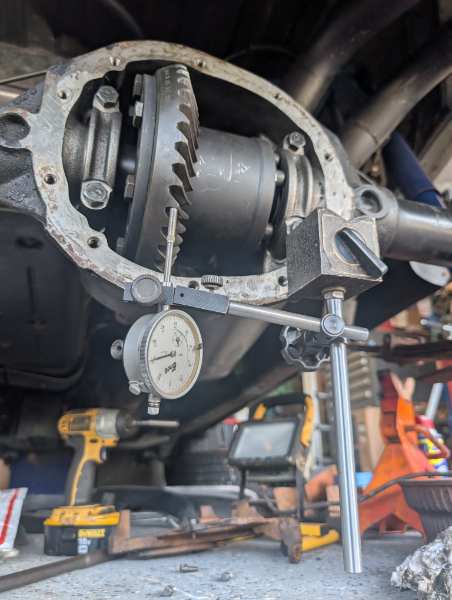

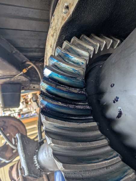

It took me a LONG time (like 10+ shim iterations between the carrier /pinion shim sets) but I eventually got a good pattern with good backlash, and good pinion / carrier preloads. Would have been easier to pull the axle I'm thinking, but hindsight's  20/20 they say.

Here's my END settings:
Carrier Bearing, "Gear Side" 0.158" Shim
Carrier Bearing, "non-Gear Side" 0.172" Shim
Pinion Bearing Shim (located between housing and under outer-race, of inner bearing :drool:)  0.0375"
Backlash 0.006"

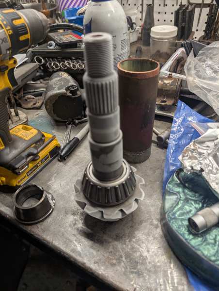

Pinion Bearing crush sleeve eliminator (0.410"+0.030" shims) (located shims towards race, not 'step' in pinion shaft itself). Measured rotation of ~15in*lbs prior to installing seal. (This is close to a few old crush sleeves I measured at 0.440" and 0.480")
Final pinion nut torque 190ft-lbs.
MY original carrier tag: 8953004770 , 3 08 605324-1
USA Standard Gear Specs:
Pinion Bearing Preload: (new bearings) 12-14in*lbs
Backlash 0.006"-0.010"
Ring Gear Bolts 55ft*lbs
Cap Bolts 55ft*lbs
Axle seals (inner seals) for "Heavy Duty" axle: Centric 41758000  (non heavy duty 41758001 same OD, but smaller ID).

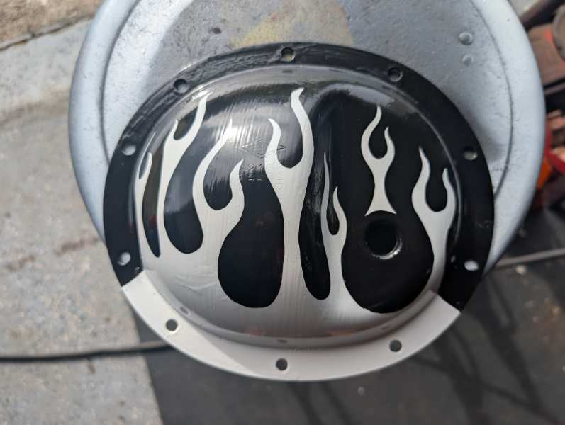

It was all rusty so I figured why not flames?

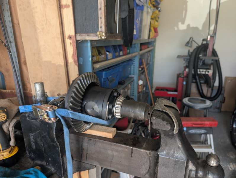

Freezing the shaft for a few hours and heating the bearing in my toaster oven at 250F, no pressing required.

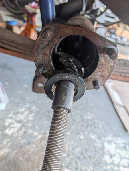

The axle puller I almost never use came in handy for popping these axles out and the seals.

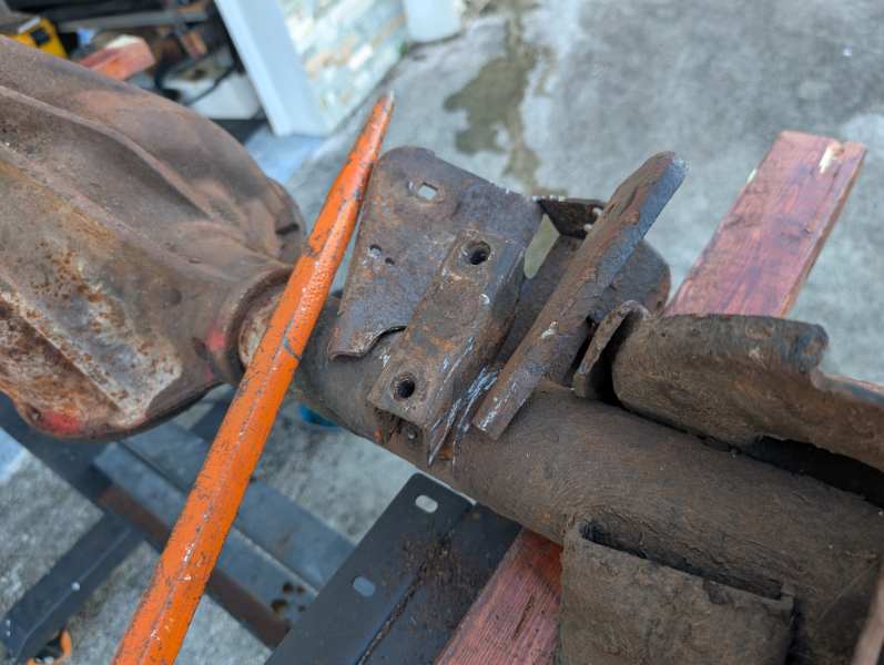

I scavenged the sway bar brackets from a 2004 Rubicon Dana 44 and welded them on my Dana 35 for a future project.

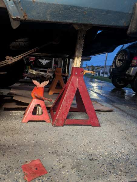

I helped my neighbor get his Toyota running and he gave me these King Kong 10 ton Jack stands. Standard 2-ton jack stand next to it for example.
