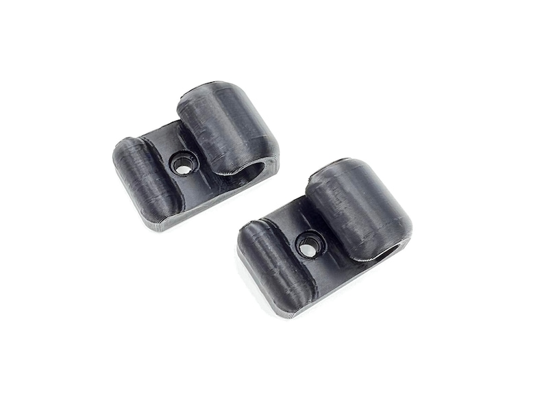

NC Tom Posted March 14, 2024 Share Posted March 14, 2024 I know these are still available to purchase, however, do we have any members who could machine them from aluminum? My plastic ones keep breaking. Link to comment Share on other sites More sharing options...
pizzaman09 Posted March 15, 2024 Share Posted March 15, 2024 Where are they breaking? I have a mini cnc mill but no longer have software to create the g code so it would take me a fair bit more time to program something up. I could picture also bending up some nice heavy sheet metal too and popping a hole in the right spot. Link to comment Share on other sites More sharing options...
Salvagedcircuit Posted March 15, 2024 Share Posted March 15, 2024 There is also a good chance the clips were 3D printed at 15% infill or PLA, which is not as heat resistant as ABS. Printing one in ABS and high infill might solve your problem. Link to comment Share on other sites More sharing options...
