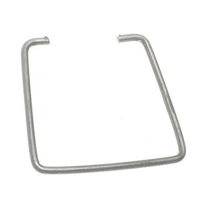

WahooSteeler Posted April 11, 2020 Share Posted April 11, 2020 Anybody know the part number or a good source for the metal retaining clips that wrap around the connector pigtail on the fuel injectors? When I swapped in my Bosch 746s, a few were missing the wraparound "hook". Looks like Autozone might have what I'm looking for but not sure if they are the right size. I have Googled the crap out of variations of "fuel injector retaining clip" and haven't run across a forum post or anything that directly linked Jeep EV1 type connectors, or Bosch EV1 type connectors etc. Fortunately they are relatively cheap at Autozone but thought I'd ask before I potentially throw $10 away. Thanks for any help......... Link to comment Share on other sites More sharing options...

WahooSteeler Posted April 11, 2020 Author Share Posted April 11, 2020 Cruiser, I have googled the crap out of Bosch clips in every way imaginable. And not sure if it would necessarily be under Bosch since these are for the connector plug from the harness and OE was not Bosch to my knowledge. I believe OE injectors were Denso, correct? May not matter what brand injector, I would guess the most important "spec" is that they are EV1 generation connector plugs. Link to comment Share on other sites More sharing options...
cruiser54 Posted April 12, 2020 Share Posted April 12, 2020 How many are you missing? Link to comment Share on other sites More sharing options...
WahooSteeler Posted April 12, 2020 Author Share Posted April 12, 2020 1 hour ago, cruiser54 said: How many are you missing? 3 or 4. Only missing 1 I think, the others the wraparound at the end broke off. I'm gonna order the ones from Autozone and see if they work/fit. If not, I would think I could return them. Worth a try at this point. Link to comment Share on other sites More sharing options...
WahooSteeler Posted April 19, 2020 Author Share Posted April 19, 2020 Happy to report the ones I found and ordered from AutoZone are the correct size. Brand is GP Sorensen, owned by Standard Motor Products and made here in the good ole U.S. of A. A bit pricey but comes 8 to a box and I could not find these type of clips ANYWHERE else on the interwebs. Part #800-9417. Pic shows one of the ones I replaced with the wraparound "retainer hooks" broken off and a new one. Link to comment Share on other sites More sharing options...

scaleless Posted April 30, 2021 Share Posted April 30, 2021 https://www.autozone.com/screws-pins-and-clips/fuel-system-retainer/sorensen-connector-clip/79660_0_0 I wouldn't really worry about the clips - the connectors seem to hold just fine without them, frankly. For $6 you can get whole new connectors, too. Just search for EV1 connectors. Link to comment Share on other sites More sharing options...
