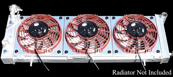

ftpiercecracker1 Posted March 6, 2019 Share Posted March 6, 2019 It doesnt get hot when parked, but does when in traffic. Hmmm. Can we get a picture of your fan setup? How many miles do you have on the rebuild? A fresh engine can run a little hot until its fully broke in. Link to comment Share on other sites More sharing options...
ratty Posted March 7, 2019 Author Share Posted March 7, 2019 On 3/5/2019 at 6:27 PM, ftpiercecracker1 said: It doesnt get hot when parked, but does when in traffic. Hmmm. Can we get a picture of your fan setup? How many miles do you have on the rebuild? A fresh engine can run a little hot until its fully broke in. I can't grab a picture right now but its the triple threat fan set up from FF Dynamics. I have about 11,000 on the rebuild. Link to comment Share on other sites More sharing options...
Eagle Posted March 7, 2019 Share Posted March 7, 2019 9 minutes ago, ratty said: I can't grab a picture right now but its the triple threat fan set up from FF Dynamics. I have about 11,000 on the rebuild. Wow! Three tiny little fans, and they claim that it will maximize cooling and increase air flow by 30 percent. Which is ridiculous, since it's the same radiator. It looks to me like that setup will reduce the airflow by at least 30 percent compared to a factory double fan setup. Link to comment Share on other sites More sharing options...
ratty Posted March 7, 2019 Author Share Posted March 7, 2019 1 minute ago, Eagle said: Wow! Three tiny little fans, and they claim that it will maximize cooling and increase air flow by 30 percent. Which is ridiculous, since it's the same radiator. It looks to me like that setup will reduce the airflow by at least 30 percent compared to a factory double fan setup. That's the one. The radiator already failed and I couldn't repair it because it's aluminum. Already had to replace the control module too because it shorted. Can't say I'm really happy with that purchase, but I didn't know what I was doing. I was thinking about sticking the stock fan system back on. Don't have time and money to keep messing with it. Link to comment Share on other sites More sharing options...
