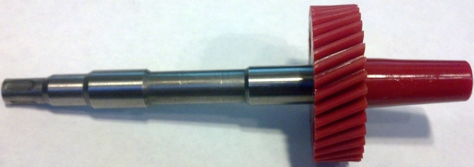

91Pioneer Posted December 20, 2014 Posted December 20, 2014 My speedo is out. It looks like a long shaft 36 tooth gear is what I need. gojeep.willyshotrod.com says I need a # 52068158. I know you can buy them new but I always prefer to buy from members here if possible. I'd be OK with a used one. I believe it looks like this:

91Pioneer Posted December 20, 2014 Author Posted December 20, 2014 hornbrod, oh by "speedo out" I meant the reading is off because of tire size. It was inaccurate when I bought it, then I put a non-stock tire size on. It's out by 10% otherwise I really wouldn't care. It's reading 10% too fast so I'd like to get it down close to where it should be. I should have said "speedo off", whoops. Rockfrog, thanks let me know. The local junkyard is 40 miles away so I don't hit it up very often and they have a lot of GM & imports, not too many Jeeps. I've read that you can remove the gear from the shaft, so a 36 short can work if I can get my gear and the other gear off the different length shafts.

91Pioneer Posted December 20, 2014 Author Posted December 20, 2014 I'm interested. Is it still in good shape? Can you post a pic? On the same page that gave me the part # it said a guy used a heat gun to heat it up and slide the gear off, and then press it onto the other length shaft, so I'm willing to give it a try. PM me a price and we'll talk.
Rockfrog Posted December 21, 2014 Posted December 21, 2014 Shoot me a link and I can probably even swap them for ya. May only need to punch them out as the ends are open. I have an old 32t I'll try on. PM me an address and I'll see what shipping will cost.
