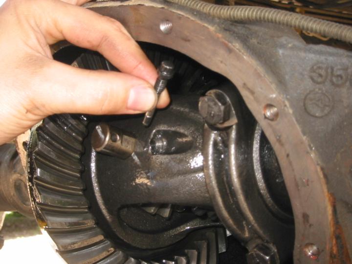

jeepthing07 Posted May 17, 2007 Share Posted May 17, 2007 all the D35 pins are threaded from what i have worked on. the D30's use a roll pin. this is the only pic i could find of the D35 pin they have a 12 point head on them and are threaded at the base. But yeah.... i highly doubt JB weld will hold it lol Link to comment Share on other sites More sharing options...
JeepcoMJ Posted May 17, 2007 Share Posted May 17, 2007 86 dana 35's use roll pins. at the very least take out the jb welded pin and put in a roll pin...it'll work and no threading needed Link to comment Share on other sites More sharing options...
