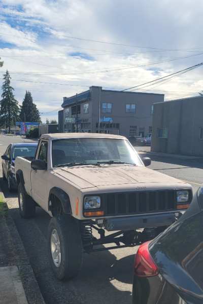

Crash Posted April 18, 2015 Author Share Posted April 18, 2015 http://rigshowcase.com/pic.php?u=207TohUw&i=15269 Better wheels on her. These are still temporary since I do not have the utility bed removed or lift on her yet. I was able to finally pick up my set of JK Moab wheels the other day. Should have one of my used sets of tires M+B soon. Still need wheel adapters. But, I have my annual Big Bear trip coming up at the beginning of next month. So, that will wait until after that. Hopefully by then the utility bed will be off and the factory style bed on. The tire size I have for them currently is 265/75/17. Link to comment Share on other sites More sharing options...

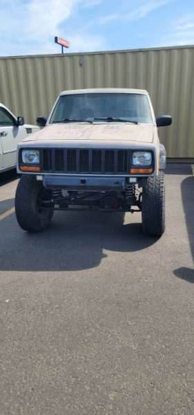

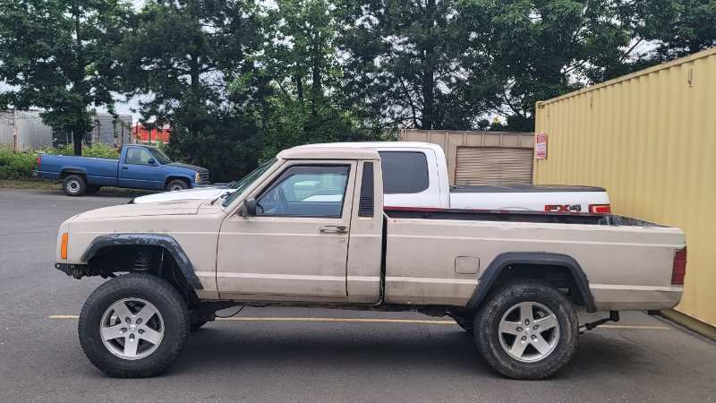

Crash Posted May 17, 2015 Author Share Posted May 17, 2015 I finally was able to remove the utility bed from my MJ. It looks like a real MJ again. It's nice to have even better visibility than before. https://drive.google.com/file/d/1D-bmmDa0TCRqdbJniJmFZONdgYYzAqrkgg/view?usp=sharing https://drive.google.com/file/d/1pv8iYhFCBccLJyOLNpdf7sUDBH7wFKhexQ/view?usp=sharing https://drive.google.com/file/d/1_E3JlZ9hukF3U2xUnhV-YLvg1XCPOgfxTw/view?usp=sharing https://drive.google.com/file/d/1Jq6aaDVD78hVj-VyrN23COEJm_tDM5O-vw/view?usp=sharing https://drive.google.com/file/d/1PuTv8VMLqRDC_i7N5iickqBAFVQiVxheLw/view?usp=sharing Hope those links work. Next up is a little bit of body work/paint. And exhaust. Hopefully, I can get the heep weight and finally reg'd. Slowly been able to gather parts for a 4wd swap. I want to keep it manual, so I am sure that a legit 4WD trans will cost the most of all the parts I need to do the swap. Link to comment Share on other sites More sharing options...

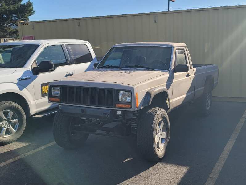

Crash Posted May 19, 2015 Author Share Posted May 19, 2015 Got the MJ weighed and reg'd today. It weighs a whopping 3180 LBS with a 1/4 tank of fuel. It still does not have a rear bumper, and it did not also have a lic. plate light, but the wiring was there, so I just used some connectors to run a led light for the plate for meow. Has a 97-up center console. All I need is a 97-up manual shifter boot to complete it. Currently running my 31x10.5 Dueler A/T's for a bit. Sold my 235/75s to my friend. He will be using them on his DD ranger. Met a guy today, whom works at Poly performance, so I have another connect there. Hopefully get a better deal than what they currently offer on wheel adapters. I will post other updates as they progress. It seems to be progressing decently, considering I have been low on funds. My friend, whom helped with the utility bed who is also the new owner of it gave some some ZJ coils that were originally on his Barney heep when he got it. I think I will toss those in and see how I like it, Otherwise I have a set of "unknown to me" lift coils in my now parts MJ, those may be slightly taller. I will be leaving the "helper leaf" setup in the truck for now as it does not hinder or affect me DD'ing the MJ. Link to comment Share on other sites More sharing options...

Crash Posted June 10, 2015 Author Share Posted June 10, 2015 Yesterday I M+B my 265/70R17 Yoko AT-s on my JK Moab wheels. Finally got some wheel lug nuts and some red loctite. Got them installed today. Looks much better. https://drive.google.com/file/d/1inhiUrXpULoEqjdNyt4u6rsQ45_y8D8DdQ/view?usp=sharing https://drive.google.com/file/d/11mToaqM6rc9EoKJ8z2PhLtLpHls9iUEJBQ/view?usp=sharing Link to comment Share on other sites More sharing options...
