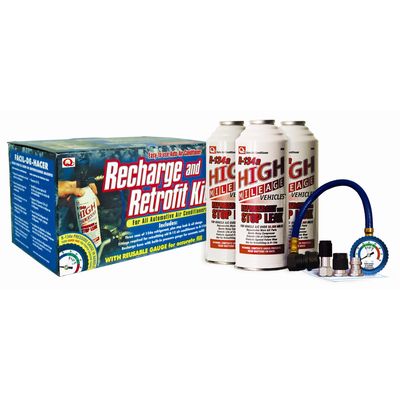

The biggest issue is that the oil used with R12 is not compatible with the oil used in an R134a system. The usual recommendation if you want to do it really right is to replace the drier and drain the old oil out of the compressor. Then you simply recharge with R134a that has the correct oil in it.
However ... the folks who make the conversion kits have some kind of special oil or oil additive that allows you to just evacuate the old R12, pull a vacuum, and recharge using their R134a with the special oil. A friend (retired Jeep service manager) tells me he has done at least fifty of these conversions and never had a problem.
4
http://www.autozone.com/autozone/access ... 13609_0_0_
  • 1 month later...
And now that the heat of summer is approaching, it's time for me to install one of those conversion kits such as I showed the image of. I have never worked on an automotive a/c. I know that with the R134a systems the low pressure side gets a small port connector and the high pressure side gets the large port connector. For an '88 XJ or MJ with the factory system, which is the high side and which is the low side?
