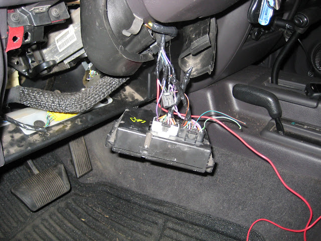

Boilermaker Posted December 7, 2010 Posted December 7, 2010 hornbrod, your memory serves you well, i've already pm'ed automan about my experiences....Due to time and monetary limitations, i gave it a try with just the ZJ overhead console and hoped it would work. And unfortunately it didn't, and as you point out the reason is mostly likely the information the overhead console needs is just not carried on our ODBI bus. There was/is a theory (not mine) that if you put a ZJ BCM into the mix that it could work, but that was further than i was able to take things. Nor have i heard of anyone being successful an OBDI XJ or MJ, yet. However, one person did manage to get this to work on what looks like a 97+ XJ from the pics. But this may have been due as much to the OBDII bus as it was to incorporating the ZJ BCM.
