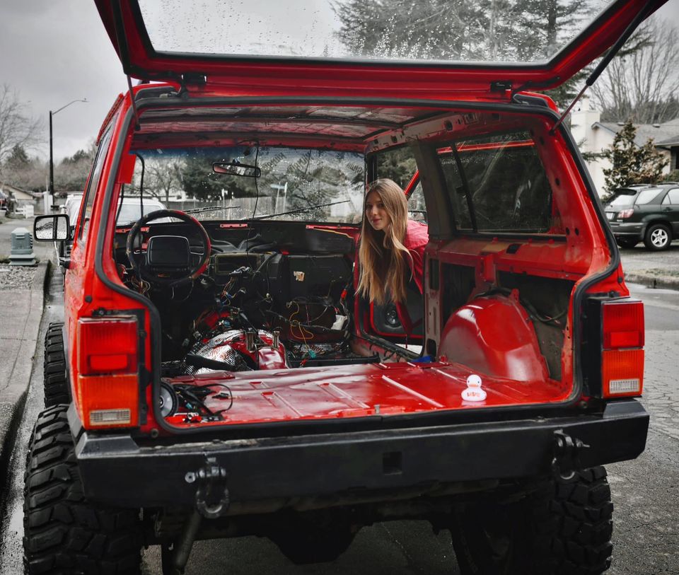

  7. Hello everyone! Here is my introduction post to the build This is my 1987 Jeep Comanche Pioneer! As some may know, a few months ago, I began the process of swapping everything from my 98 XJ into my 87 MJ. Just like my last post, I made a dumbed-down to-do list: Preparation and Disassembly: Strip the MJ completely, including interior, drivetrain, and accessories. Use labeling, bags, and photos for organization during disassembly. ✅ Sheet Metal Work: Modify the firewall to fit the XJ components. Patch holes, resize openings for the fuse box and steering column, and seal the firewall properly.✅ Dash Mounting: Fabricate new bolt holes and tabs for mounting the dash. Weld braces onto the firewall for upper dash mounting points and steering column support.✅ Under Hood Accessories: Move accessories like washer bottle, ECU, cruise control, and wiring harness from XJ to MJ. Install under-hood wire harnesses, vacuum lines, brake lines, etc. HVAC Box: Install the HVAC box without the engine in place for easier mounting.✅ Drivetrain Installation: Drop the drivetrain into place, check motor and transmission mounts, and measure for driveshaft compatibility. Interior Insulation: Optional. Add insulation to the interior, especially the roof, back of the cab, and floor. ✅ Wiring: Transfer and label wiring harnesses from XJ to MJ. Install bulkhead connectors, route looms, and connect various electrical components. Interior Reassembly: Install trim, console, bench seat, and other interior components. Fuel: A few options here. (1) In-line pump (2) Use an adapter ring for the XJ fuel pump (3) Swap MJ tank for Dakota or TJ tank. Continuing from my last post: Once I had the thing down to a shell, I started prepping the body. This included any/all rust repair, swapping the firewall from the XJ to the MJ, paint, rust prevention - and just for fun, sound deadening. Almooost factory Wanted to freshen up the trim while the weather was nice... Before: After! Por-15, sound deadening, and carpet padding (old stuff was TOAST) Bought a (dirty) parts Jeep! Carpet flip Cut to size and molded to fit! Bench seat ready to go in Test fitting! Windshield delete New dash mounts, bolts, and steering column support in Dash paint matching... DASH TEST FITTING!!! Now I'm moving on to the wiring and under hood accessories. The harnesses were not the nicest, and since time/energy isn't an issue - I'm tearing it all apart and re-sleeving while I figure out what I do/don't need. Somewhere between wiring and fuel, I'll start to drop the drivetrain in. This, funnily enough, should be the easiest part. As for fuel, I'd like to test out something different. I plan on running an in-line pump, instead of an adapter for the XJ pump/MJ tank or swapping the tank out for a Dakota/TJ tank. I've swapped to in-line on a few of my diesel trucks - and thought I might as well give it a go with the MJ. I'll keep my post updated as to what I end up doing here. Feel free to let me know if you've got questions or advice! I'm always open to chat about my projects

    1987 Jeep Comanche 4.0L AMC, 5 Speed Manual, Floor Shift, Part-Time 4WD 7.0' Bed, D30 & D35, 120" WB Hello! My name's Bree and this is my white and blue 1987 Comanche I bought the cab from a friend a while back and planned on building a rock bouncer. Coincidentally, found the original bed (and the original owners!) on Marketplace a few months later and, of course, had to pick it up. Another couple of months went by and I found a totaled 98 XJ with 120k on the 4.0 and an AX15. The plan has since changed and is now to fully restore it with a twist. I came across one too many perfect coincidences, and the white and blue trim is just too cool. I'll be keeping the blue interior plastic, door panels, original blue bench seat, and keeping the body completely stock. As for its "guts," I'll be swapping in the dash, wiring/electronics, fuel, accessories, and drivetrain from the '98. This past weekend, I completely gutted the '98 and scrapped what I couldn't get rid of. This coming weekend, I'll modify the firewall and test-fit the drivetrain. If anyone's at all interested in the conversion, I made a dumbed-down to-do list: Preparation and Disassembly: Strip the MJ completely, including interior, drivetrain, and accessories. Use labeling, bags, and photos for organization during disassembly. Sheet Metal Work: Modify the firewall to fit the XJ components. Patch holes, resize openings for the fuse box and steering column, and seal the firewall properly. Dash Mounting: Fabricate new bolt holes and tabs for mounting the dash. Weld braces onto the firewall for upper dash mounting points and steering column support. Under Hood Accessories: Move accessories like washer bottle, ECU, cruise control, and wiring harness from XJ to MJ. Install under-hood wire harness, vacuum lines, brake lines, etc. HVAC Box: Install the HVAC box without the engine in place for easier mounting. Drivetrain Installation: Drop the drivetrain into place, check motor and transmission mounts, and measure for driveshaft compatibility. Interior Insulation: Optional. Add insulation to the interior, especially the roof, back of the cab, and floor. Wiring: Transfer and label wiring harnesses from XJ to MJ. Install bulkhead connectors, route looms, and connect various electrical components. Interior Reassembly: Install trim, console, bench seat, and other interior components. Modify A-pillar trim if necessary for a proper fit. Fuel Tank: Install a new tank without a slosh pan, use an adapter ring for the XJ fuel pump, and relocate the charcoal canister for emissions compliance This is how it's currently sitting (minus the steering column & wiring). I'd like to have a more satisfying end to my post but I'm only now getting around to prioritizing the build. I document a lot of my work on my Instagram if anyone is interested in the progress. The door label has been lost to time, but I do have the original Vehicle Building Order: The car's still under the original owner's name. After meeting him and chatting, I filed for a lost title and am getting everything signed over. Located on the Columbia between Oregon and Washington. Feel free to let me know if you've got questions or advice! I'm always open to chat about my projects
