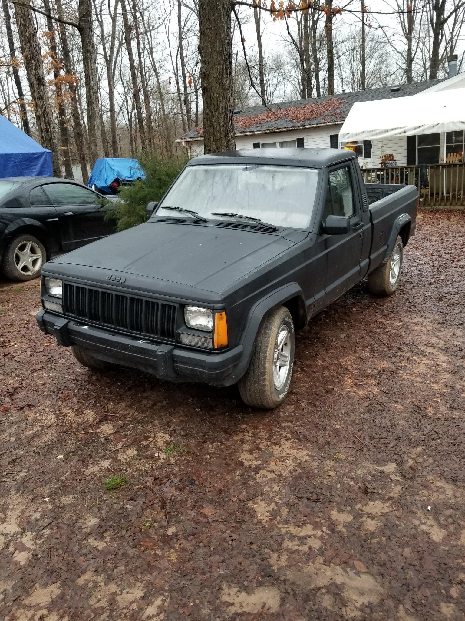

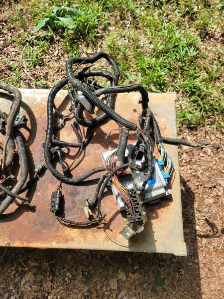

I have a 1986 Jeep MJ 2WD pick-up for sale. I have the title for it. I will sell the engine/trans and all supported wiring/computer for $1000. This Comanche is a project with a 1995 Chevy 5.7L (350) engine and a 4L80 transmission. The engine/trans and wiring harness came from a 1995 G20 van with about 65K miles on it. The engine starts and runs great. But the install is far from finished. It still needs a cooling system the exhaust and the driveshaft built. It will need the dash installed and probably a few other small things. It will need a front clip also. I have this listed on marketplace. There's a video of the engine running. https://www.facebook.com/marketplace/item/1964877190744398

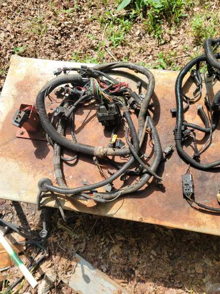

1989 MJ XJ 4.0L 2 wheel drive manual transmission under hood wiring harness and computer. $200 This is the harness that doesn't have the 101 plug. This is the complete under hood wiring harness, as far as I can tell. From the fuse block to the head lights. There are no sensors or relays included. Wires are in good condition and all the plugs are usable. Some of the plugs will need cleaning but I think everything is there. I can ship, buyer pays shipping. I'm in Commerce Ga.
